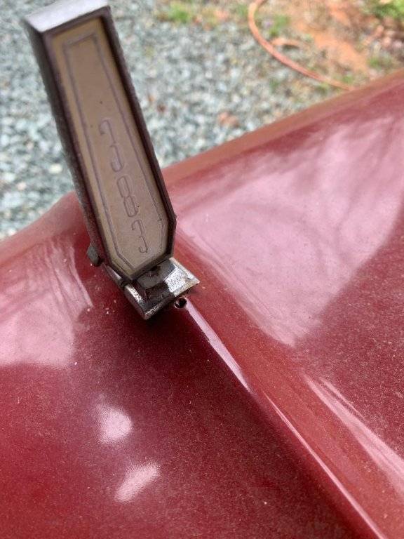

This hood ornament does not seem to fit very well.....loose on the hood ridge, and cockeyed when tight. Also, a small hole behind. I am happy I took this pic because I did not see the 383 on back side. Does this appear correct, and could it be reversed with maybe a pin that goes thru hole, yadda yadda. Thoughts appreciated.

Looks like you might have the wrong base. Note that a hood ornament from a 66 Belvedere/Satellite and Fury look the same but have a different base due to the shape of the hood. If you find a '65 or 66' Fury base for the ornament, that should work.

Yeah, same thing happened to me when I bought my Fury. Someone put a B-body ornament on the hood. It was cockeyed, the wrong year, and the wrong engine. Looked at Pinterest to see photos of several '66 Furys to know what to look for. Then got on Ebay and found an ornament for $75, and now it fits perfect. If you have a good Mopar salvage yard nearby it's a godsend! You're halfway there, just need a different base.

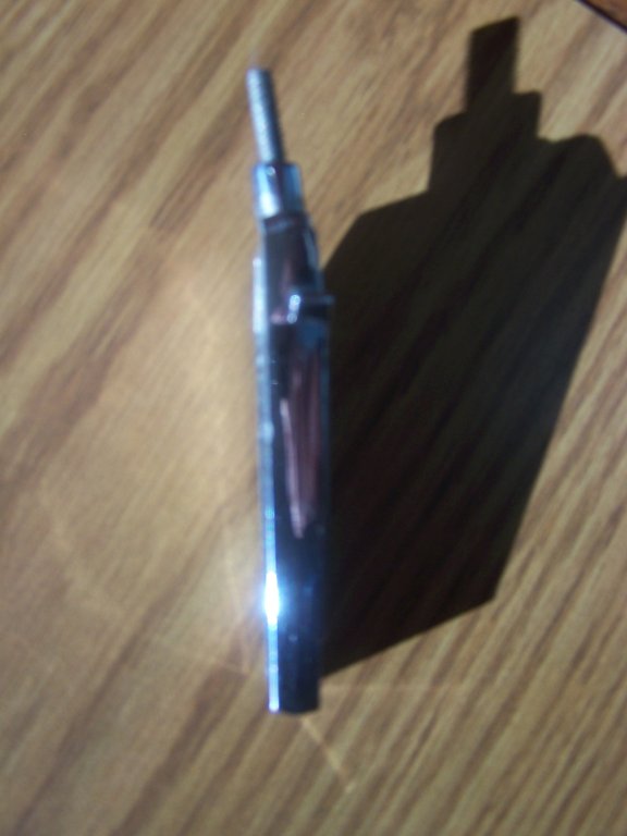

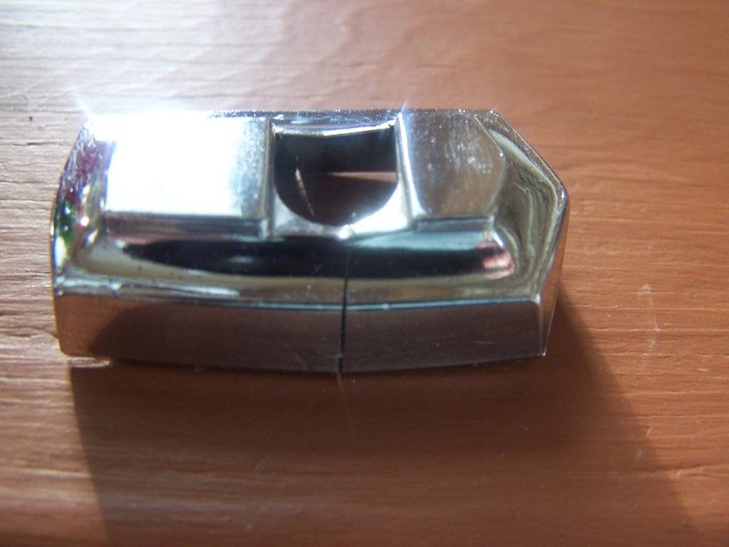

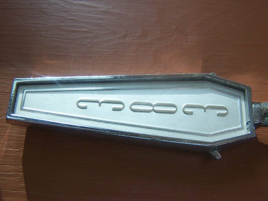

Yes. The correct base will have the locating pin. Here is a pic of the correct base for a 66 383 hood. Mine was cracked and I sold it a few years ago. Good luck finding a usable one.
Yee gads....thank you guys.....these are the first I have seen of what should be on my hood. I have the correct vertical 383 emblem, but neither of the other two....all gonium. Thanks for letting me know what I should be looking for. If I were not in my retired state, I might go for the ebay item. appreciate the help
BTW gentlemen, in both examples, the nut sits on the spacing block. Is it attached and spins, or loose. I am looking up into the hole in the lower hood, and it is interesting to install this thing. Was considering using a magnet and socket to hold the nut??

It is a captured nut that spins.
