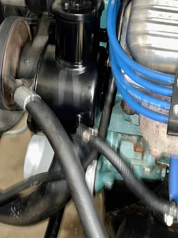

Mine has the 1.2 pump, and I cant figure out how the 5/8 hose is supposed to double up and run down to the gearbox without kinks. The gear return is almost directly below the pump, and both fittings point up. I guess I could route the return back thru the compartment to avoid kinks, but am not understanding OEM on this. Mine has a kludge kit of fittings to make this 180 degree bend. thanks
can you take a pic of your setup? I just rebuilt my ps pump and put in new lines for both but don't know if its the same pump as yours
I had the other type of pump originally but this one from another car I parted out was in better shape to rebuild when the one on the car went bad. If this is the one you have hope it helps

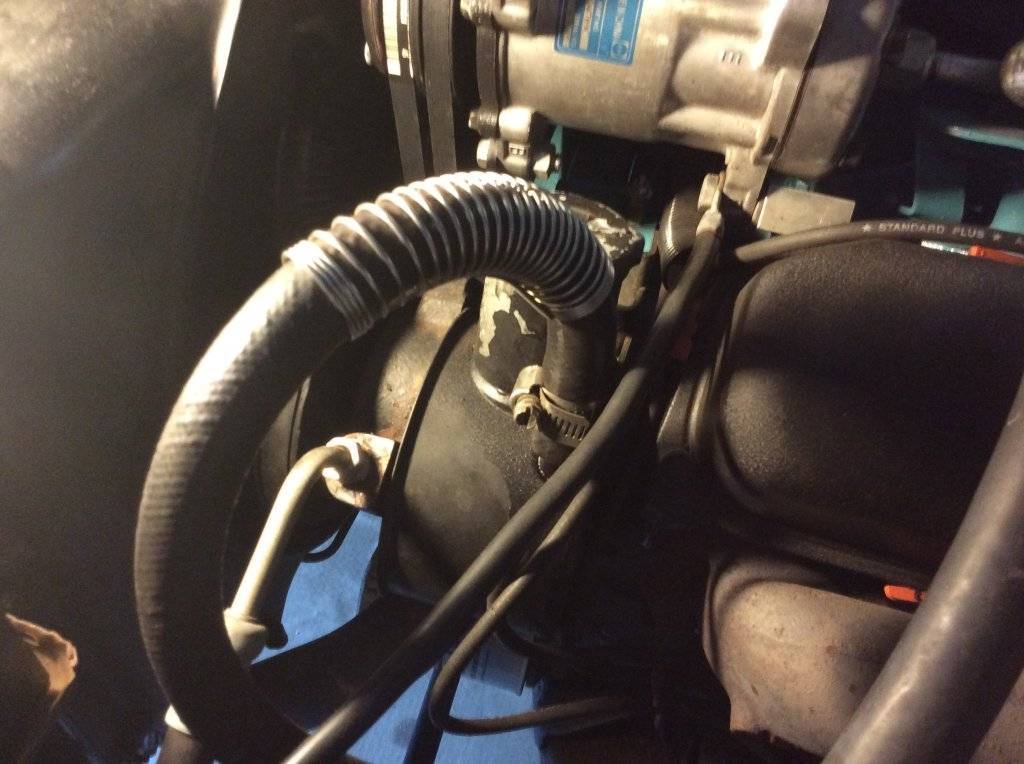

They make these up to 3/4, have used them on lots of things and work great. You can use 2 to make up to a 180 bend.
Cool! Never saw those before!

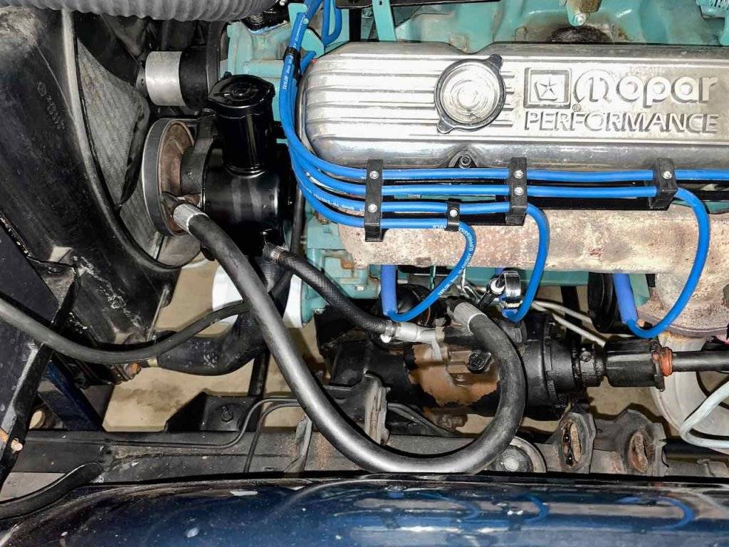

FWIW - here is a picture of the factory power steering return hose and its preformed bend that it has in it just before the nipple on the pump.
I managed to find 2 NOS ones about 20 years ago.
Yup, yup, yup and yup. All great points. But, I have to say I wish my RoadKill engine looked like HotFury's.....yee hah. But, the hose is like the latter pics, straight up.....what was Chrysler thinking. And, I might try the springie thingie, might help when I replace the Kludge I have now, from about four parts to make the bend. Thanks all.

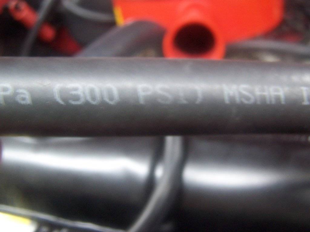

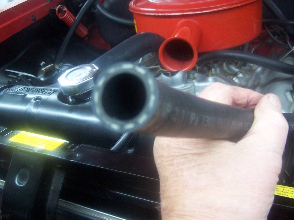

I bought a 300 PSI hose from a shop that supplies hydrolic hoses. They have a stiffer wall that don't kink. Here are a couple pics of a hose on my 60 Dodge. It is made by Parker.
thanks muchly both. I got the springs, have not yet tried but fit the hose. If does not work, will look into the HP hose....thanks
