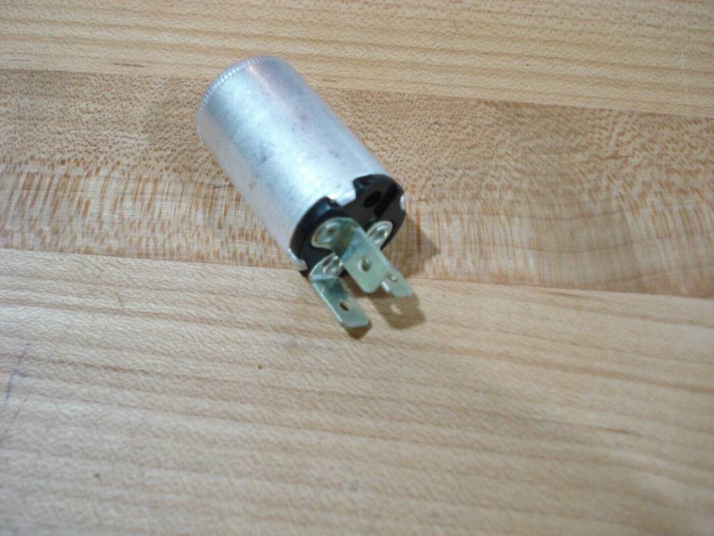

Where is this timer located and how can I test its operation?
Looks like this and it's just attached to the wire harness. about 3/4" in diameter. Test it by opening the door, then closing it and waiting for the light to go off.
66s don't have the timer. It's key on only, and it's therefore completely useless both in brightness and operation. I gave up in trying to retrofit mine with a timer and wire it into the door light circuit.
