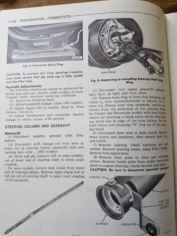

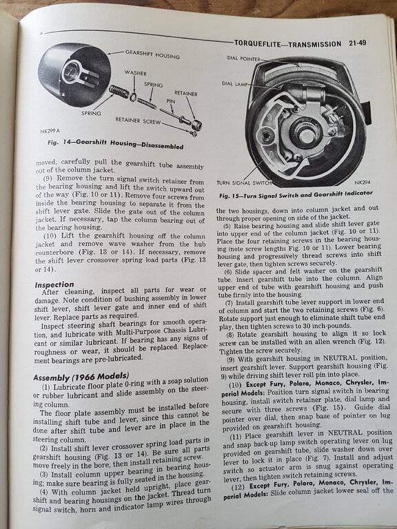

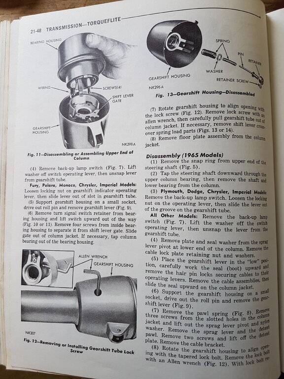

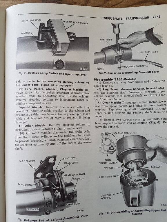

I'll try and look things up in my Canadian service manual and post some pics and instructions. Where in Ontario are you? I live near Brantford. Let's see some pics of your car!
So - looking at my Canadian service manual it doesn't provide any more info than you already have.
Steering wheel must come off. You need to use a correct steering wheel puller, which are available from Canadian Tire for cheap. You twist the centre emblem to remove it, then IIRC, you remove the horn ring with 3 screws (don't lose the rubber washers), and this exposes the wheel nut and wheel spokes. That's when you use the steering wheel puller. Use a grease pencil or a sharpie to make a couple of marks on both the centre shaft and the wheel to align the wheel when you want to reinstall it. Don't remove the nut all the way because the whole assembly can come off with a fair amount of force into your face - the nut being on a few threads will stop it flying off once the puller makes the wheel release from the splines of the centre shaft.
The horn ring is not in the way apparently, but it does not detail the removal of the turn signal lever arm so it must be very obvious as indicated above by @rapidtrans .
Here are pics of the pages from the service manual:
