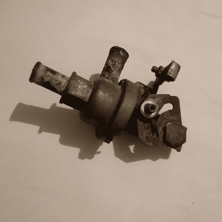

I strongly suspect it used a 1/2 heater core from the factory, the original rivets sealing up the core were still there unless someone was actually bothered enough to use new rivets. The heater valve also seems to be some local model, a 90° valve with 1/2" barbs on either end. It's pretty much impossible to find so I had to use a 1/2" push-to-close valve from a British motoring performance shop. The old valve:

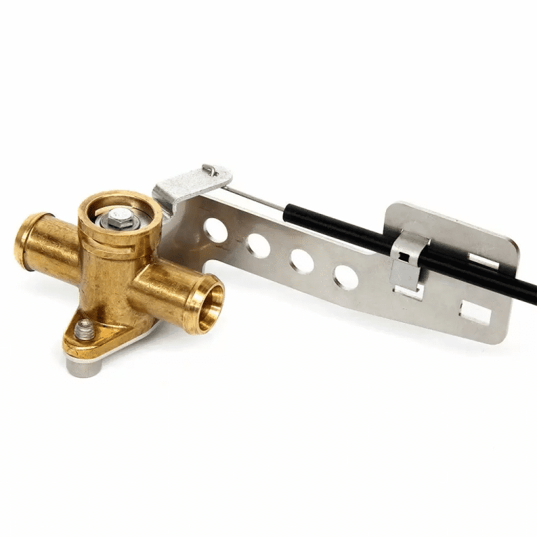

Versus the new valve I got:
The barbs were just a tad bit large for the hose I got, so I ended up grinding them down a bit to make it fit easier. The barbs also have a sharp edge which will cut into the hose leaving rubber shavings behind, so I made a smooth bend of that as much as I could. The great thing about this valve is that it's apparently fully serviceable, can be taken apart if it needs to be cleaned out. The only drawback is that the heater temp lever in the dash doesn't actually cover the full range of this valve; adjusting the cable so that it's fully closed means that when the lever is fully opened, the valve itself is actually only about 60% open. Adjusting the cable it so it fully opens then results in the fully closed position still actually allowing some coolant to flow through. As far as I can tell, an attempt to fix this would require removing the in-dash lever and bowden cable clamp, and cutting and welding something up, and doing so at the heater valve itself would require extending the lever and bracket that the valve is screwed on to.
