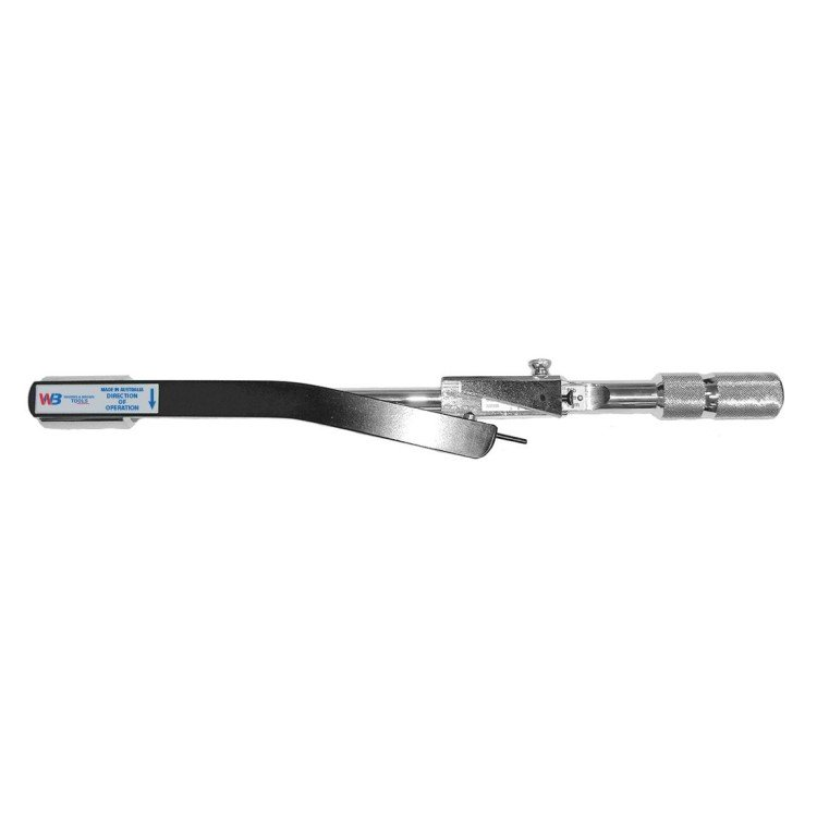

I would if it were an old clicky one, but this is one of the fancier deflecting beam wrenches:
It's a different take on the older beam wrenches - these have the very useful feature of being able to hear and feel the click.
Accuracy is rated to ±2% whereas the cheaper clickers were ±4%. Very common to see rusty, beat up, 20-30 year old ones still well within spec. This one I've had for five years but it hasn't seen the use and abuse that a professional workshop would subject it to, so I'm still very confident in its accuracy.

Wow... I've never seen a torque wrench like that. We calibrated hundreds of torque wrenches every year in our calibration lab too. I retired 10 years ago, so this may be too new... or it may be something we don't see in the USA.
But, yes, generally speaking, a beam type wrench is accurate and will stay accurate. You still don't want to use it as a breaker bar, but they are the best bang for the buck. One thing about torque wrenches are they are usually accurate in their upper 80% of the scale, but I didn't see that noted when I looked up this wrench (because I had to know!)
...so this may be too new
I think these have been around for a while; I bought my first deflecting beam on Gumtree second-hand and it looked like it was made in the 80s or so. Sold it and got this one because I got sick of the non-ratcheting head. You guys also have them but they don't seem to be as popular, Powerbuilt sells a model that looks identical to what I have: 1/2 in. Dr. Deflecting Beam Torque Wrench
I think this one has a ratcheting head judging by the pics. It doesn't actually say though. Seems to be on sale right now as well - 95 bucks instead of 180, if you want to get one now might be the time especially since it says it's got 2% accuracy.
One disadvantage about these types of torque wrenches is that they only torque in one direction, if you've got a left-hand threaded fastener you'll need to use the regular beam wrench.
