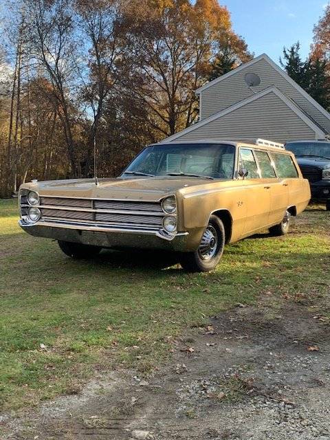

Been a while since I've last visited. Doing A body stuff lately. Now I'm getting my wife's 67 Fury wagon ready for the season and discovered the power steering pump is leaking. It's the round Federal style. I'm looking on Rock auto and Ebay and it seems like there are a few aftermarket pumps out there. Cardone, BBB etc. Looking at the pics they don't exactly look the same. Anyone buy one of these and was there any issues? I'll also get a new hose and pressure line. Thanks.
