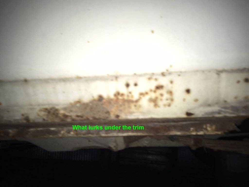

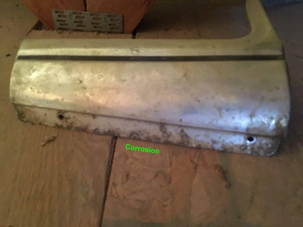

The similar trim that runs the length of my 67 Polara 500 was completely rotten. The aluminum does not do well when placed against steel, and rots the quarter panel as well in dissimilar metal corrosion. I don't think your car is in a bad of shape, though. The trim is held on with little steel hairpins that go out from a central hub, you lift the trim up slightly and try to depress that steel wire that snaps into place around the periphery of the trim. Those clips tend to rust, too.

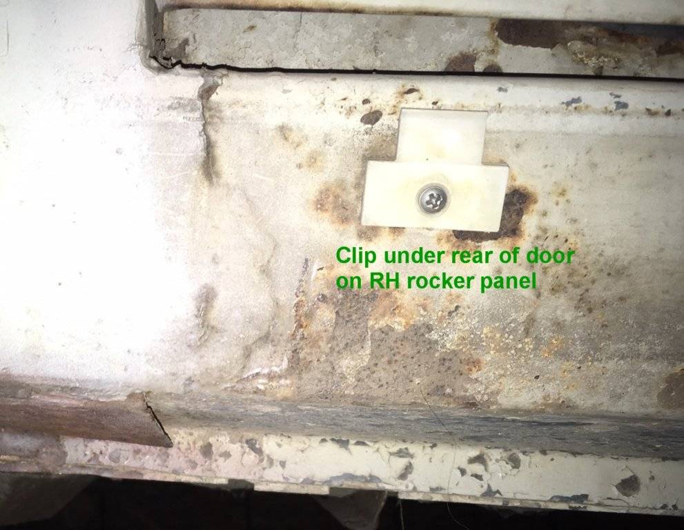

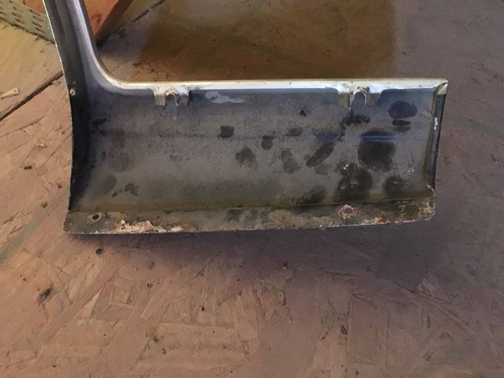

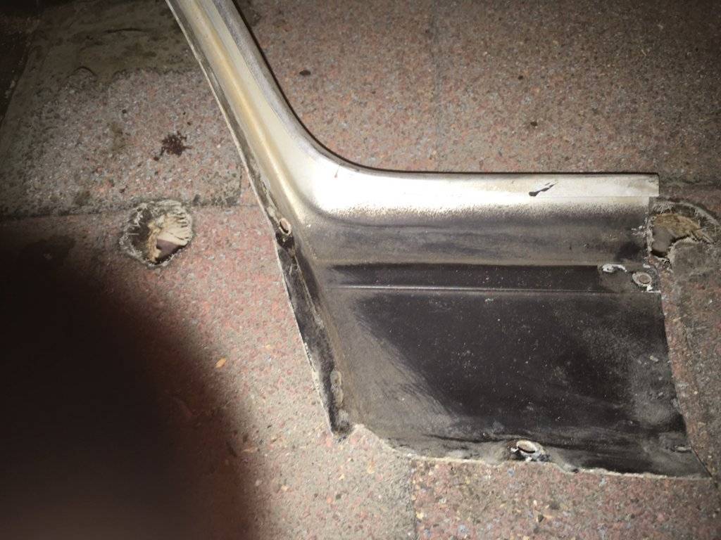

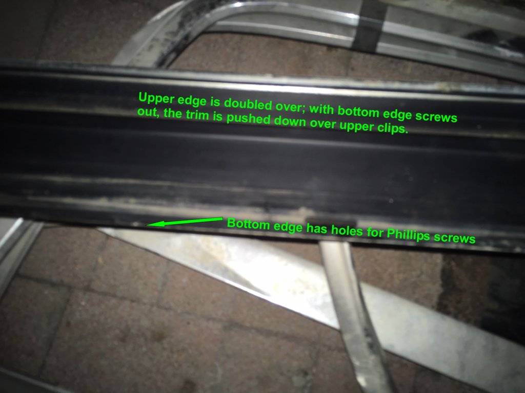

The trim has the upper edge rolled over 180 degrees, and is slid down over plastic clips. Then the phillips screws are put in on the bottom side, where they are out of view. I though I remembered some hair pin clips as well, but I might be confused on that. (that chunk of metal has already been cut out). It was the area of the quarter panel right ahead of the wheel well. Hope these photos help. They are in my attic and good photography was not possible up there. Plus it is hot!
