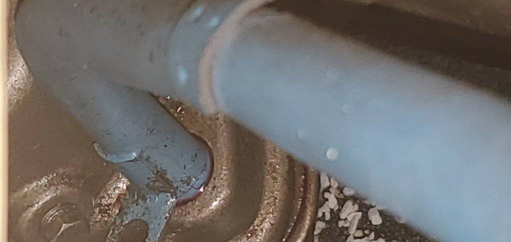

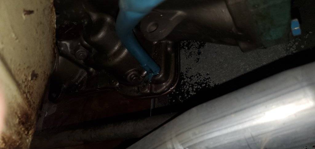

My 67 with a 383 and 727 is leaking at the o"ring I have replaced it and it still leaks. Not immediately but after a couple of weeks. I am not sure if I have the correct dipstick tube or the correct transmission for the Dipstick tube. The dipstick has a tab to bolt onto the transmission but the transmission des not have a corresponding bolt boss.
I saw in another thread that 66 's took a dipstick with the bolt and that later 727's did not have this. so eitther sometime in the last 55 years the transmission was replaced with a later trans or the dipstick was replaced with an earlier one.
The dipstick is bolted to the block but the tube looks like it raises out of the block. I am contemplating cutting offf the tab to bolt it to the transmission or is their something special or different with the newer design.
