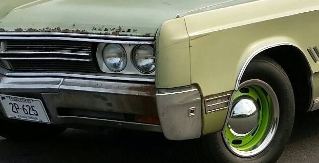

Here's a pic of the nose of my car. I'm assuming that the clear lamp in between the bumper and the front of the front wheel opening is a cornering lamp, please correct me if I'm wrong.
Chris
Thanks for setting me straight.
Next stupid question - when are those lights supposed to come on? Are they parking lights? Running lights?
The tiny amber lights in the bumper come on with the parking lights and stay on with the headlights.
Thanks again...
Chris
The ones in the bumper are the marker lamps, and yes the clear lense is the cornering lamp which should stay on constantly when the signals are on.

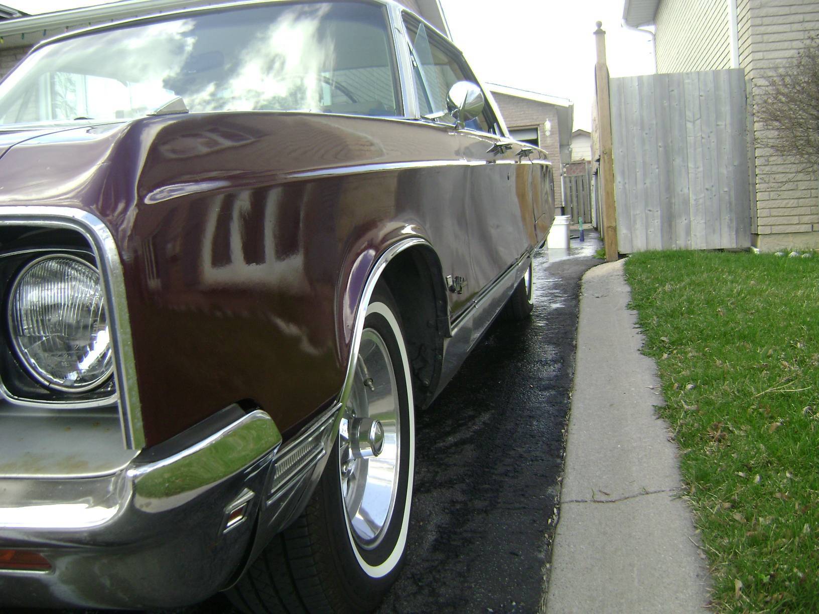

A lot of hits and misses here, heavy on the misses.
There are no side mando turn signals on the side; they are just marker lights. That was a one year only thing in '68 for every Mopar from the Valiant to the Imperial. In '69 they changed to a reflector and in '70 a light reflector combo.
The car in question here and green example car have the large clear side lights and are indeed optional cornering lights that, like previously stated, stay on while the turn signal is on.
The turn signal switch for cornering lights is indeed different and is not interchangeable with a standard switch. The switch for cornering lights is red and the standard is white and you can easily see it at the base of the lever through the opening in the column.
There is a place in Colorado that makes the red (with optional cornering lights) switch new. I got one ordered through Sturdevant's and they evidently build them after you order them and it was about $150 around 6 years ago. The standard, white switch is a common item, many warehouses would have them in stock and they are much less expensive.
