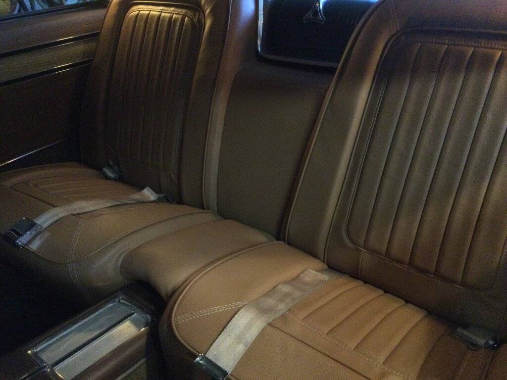

When I had my interior done this summer I figured my stitcher guy would just grab some foam and build up the rear seat for the Monaco. Got a quick lesson on foam densities, muslin wrap etc. No they don’t just by some foam at Hobby Lobby and have at it. The base foam they used came with the burlap or muslin on the underside which was very hard to find last summer. This gives them something for the hog rings to grab and clamp to seat springs. They used at least three different density foams to build up that rear seat to reproduce the factory bucket effect.
This I'd like to see, got any pics?
Here you go. (The seat isn’t pushed down into the floor cleats in this shot)
There are two layers of different density in the bottom seat and another density foam for the bolsters and the center pleats.
