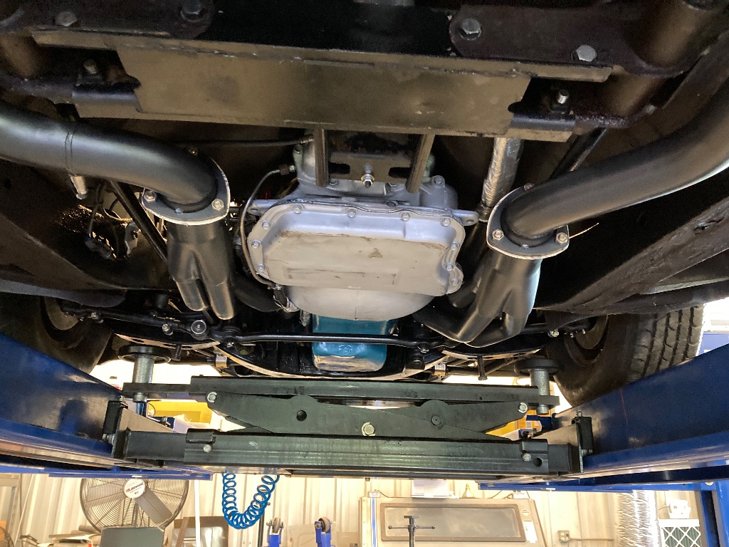

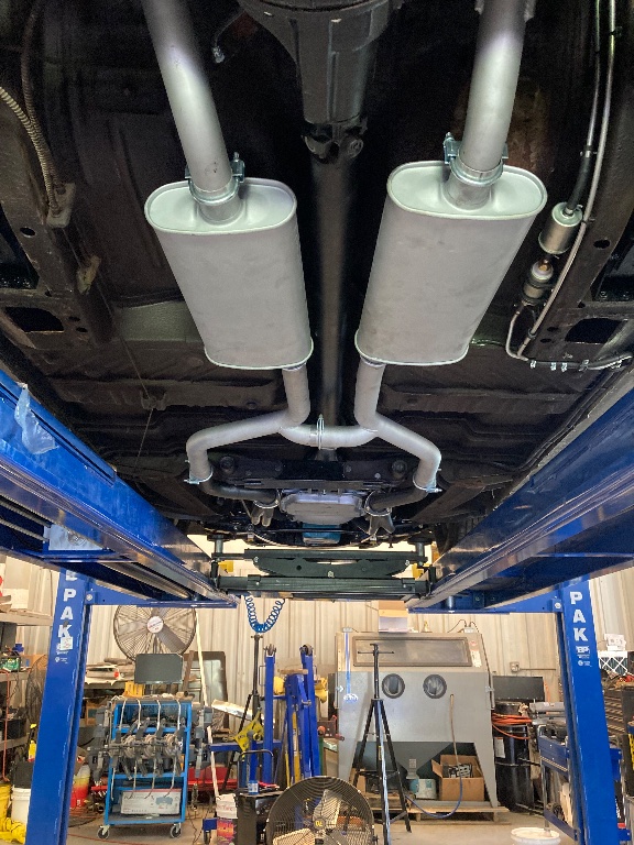

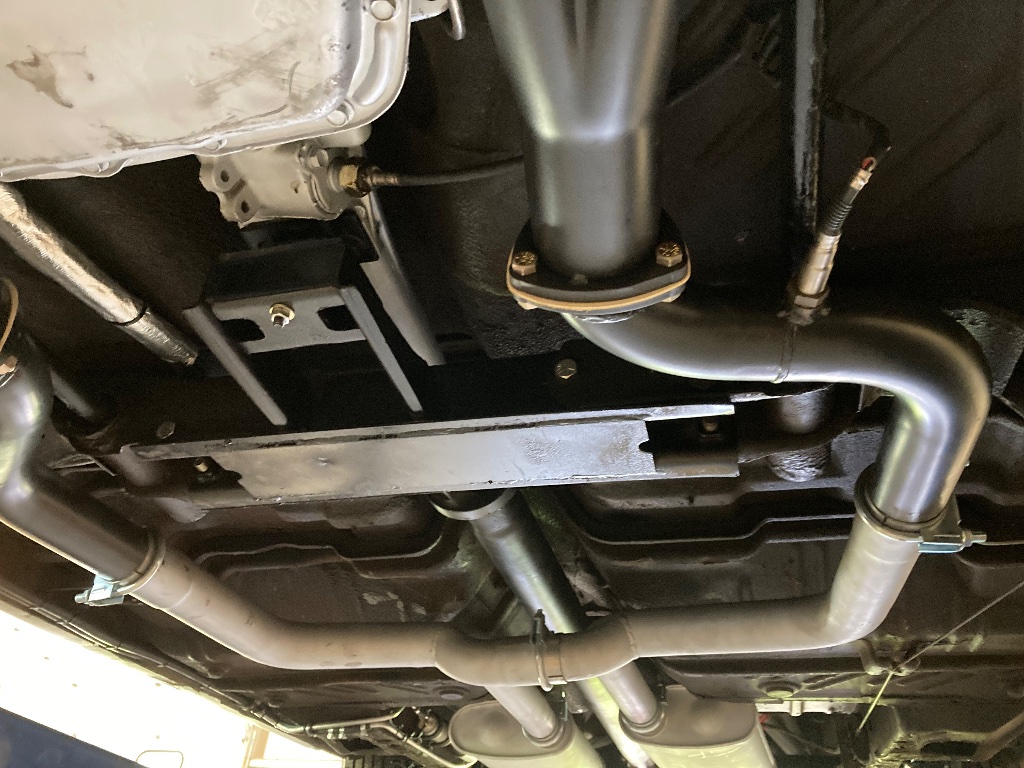

My '67 300 with a 440 has a full TTI exhaust from headers all the way back, with an O2 sensor bung for my Holley Sniper. No issues after three years. Louder than stock but nowhere near obnoxious and does not drone at highway speeds.
Highly recommend TTI. The quality is remembered long after the price is forgotten.
Is that 3" exhaust? Looks awesome!
Also, i always thought TTI put the O2 bung in the collector - i see now you decide either collector or reducer/adaptor - is one better than the other? Application specific (Holley instruction?)?
2 1/2". And thanks.
