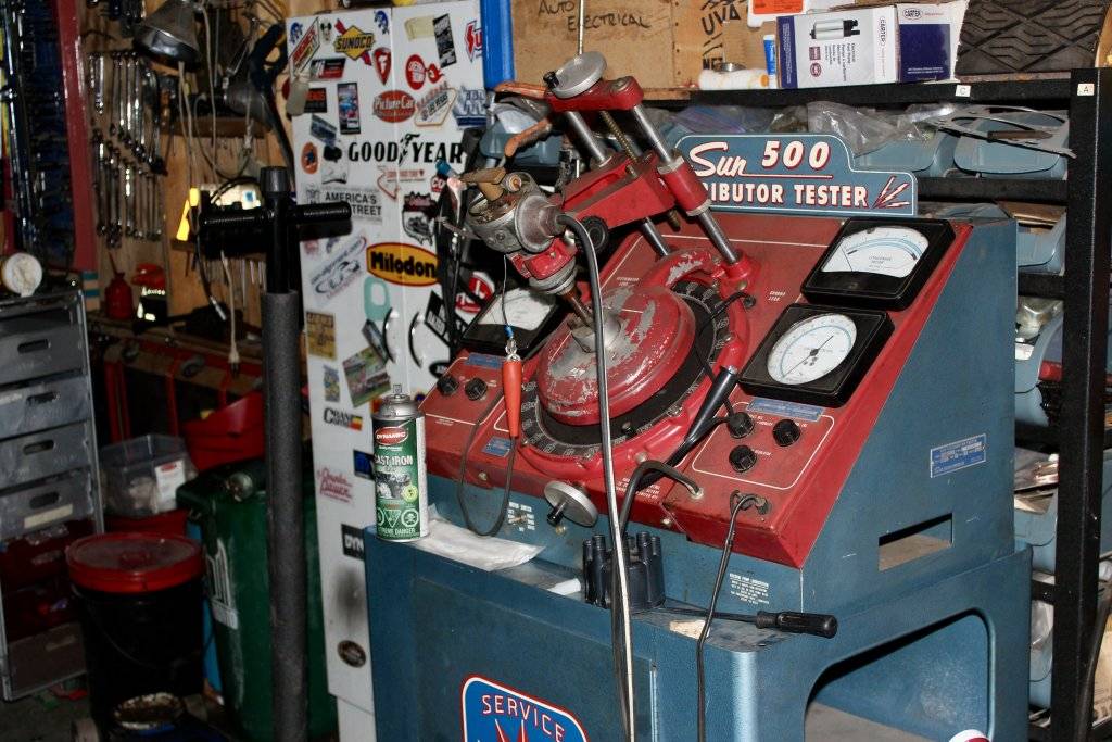

For finding your timing you will need a dial back timing light and a vacuum gauge with test drives. Then you need to recurve your distributor with what info you found and the total the engine is good with.
Do a compression test first.
One of these comes in handy.
Tall John is a good source.
