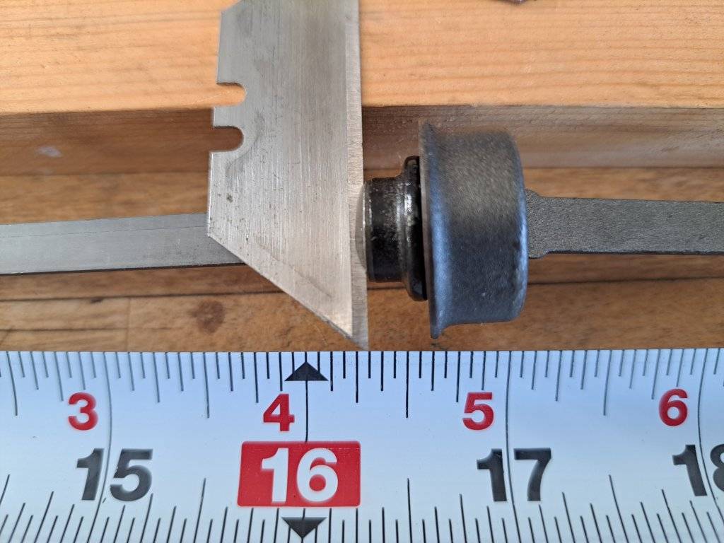

From the round metal piece under the rubber seal it’s 16 1/4” to the full line.
Thanks guy's. I appreciate your efforts. At least now I have something to reference.

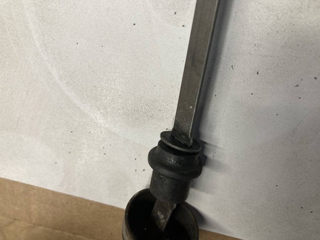

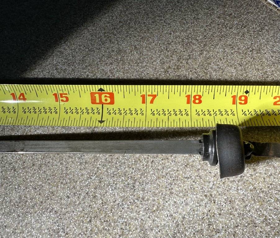

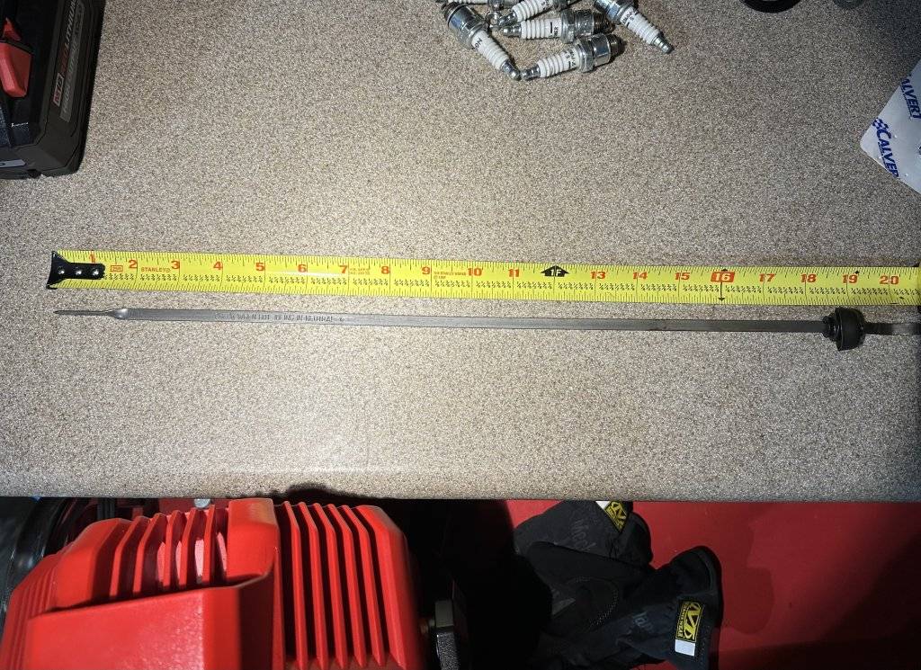

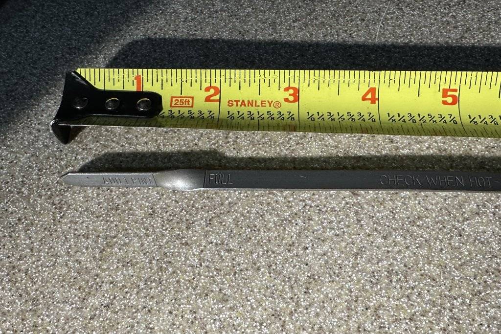

Confirmed 16-5/16" from full line to metal retainer. So....I'd have to say it's ok assuming the filler tube is original to the vehicle which I would have to confirm.
Not to cause trouble, but are all the dipstick tubes the same length? The pair need to work together. Just a thought. Lindsay
A Chrysler transmission engineer once told me that the tube and stick HAVE to match. Which only makes sense.
