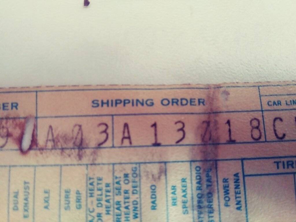

Found out by a buddy who had trouble getting a car across the border a few years back..
The customs officer had no clue that 68 Chrysler products used the shipping order not the vin so at first they thought the car was bogus stolen or whatever.
Anyways.. The shipping order is on the broadcast sheet right next to the VIN.
At the time Chrysler used it as its own reference.
68 was last year for stamping the SO on body panels.
69 saw VIN being stamped.
So when you find the numbers on your car it will look similar to something like this...
Found out by a buddy who had trouble getting a car across the border a few tears back..
The customs officer had no clue that 68 Chrysler products used the shipping order not the vin so at firdt they thought the car was bogus stolen or whatever.
At the time Chrysler used it as its iwn reference. 68 was last year for stampingvthe SO on body panels. 69 saw VIN being stamped.
So when you find the numbers on your car it will look something like this...
