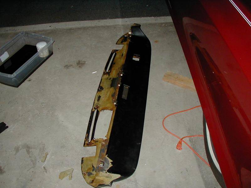

Can anybody tell me how to remove the top part of the dash pad. It's got an ugly crack in it that I'm gonna have fixed. I'm confused as to what is holding it down. Thanks!
Screws in the front towards the driver and studs towards the windshield. Remove all of dash cover plates, glove box door, glove box, defroster vents, air ducts and instrument panel and whatever else needs to be removed to reach the nuts on the studs. The side towards the windshield will then have to be pryed up to allow the studs to clear the dash frame to remove the pad. TIP....4 hands are needed...
