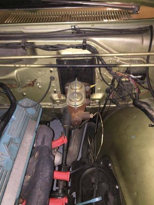

Here is the MC setup

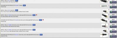

But there seems to be different types. screw in or push in. Anyone know the type? Rockauto has them. just need to figure out which one it is. Then figure out how to get it out and a new one in.
If anyone has a suggestion onthe swithc type. i'd appreciate it. Thx. Tdube.
When the button is out, the switch is made and you have power to the brakes. The bracket that the switch is mounted should be adjustable. Did you try to adjust by loosening the bracket, and re-positioning the switch? No need to replace the switch if you know it's working. Also hard brake pedal most likely due manual brakes, (no power assist.), may want to look into that upgrade in the future.
