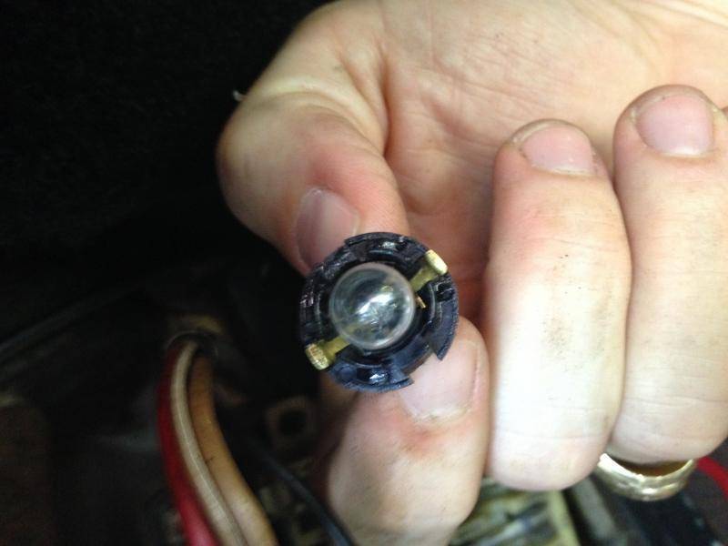

My driver side dash turn signal indicator was going in and out a couple months ago and now has completely stopped working. Did the simple ( change the bulb) still didn't work. The passenger signal works fine it is wired separately, but the drivers side uses the circuit board.
I checked the fsm but didn't see much else to help with this. Could it be the ground to the circuit board? Are there any tests I can do to check this?

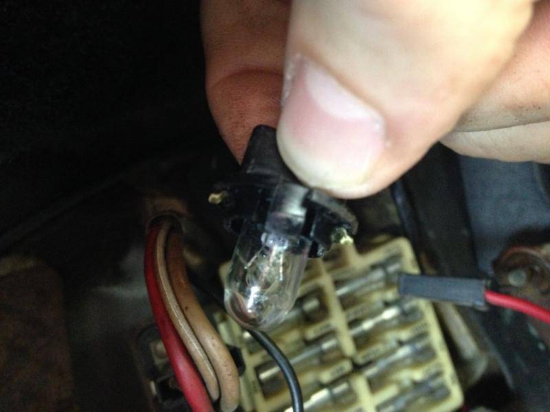

i attached a pic of the bulb and the bulb holder so you guys can tell what's going on. All help appreciated
Double check the bulb. I've had more then a few that were junk right out of the package. That's why I usually buy a pack of 10....;)
Are you sure the bulb you changed is the turn sig bulb .....? it can get pretty confusing working behind the IP sometimes.
That's another good suggestion. I didn't think of it until the above response...but if one side is wired separately...then I would suspect that the other side is as well. I bet that is a bulb for some other dash function.
Bulb is working but signal indicator is not. It is the correct bulb location ( I agree it is weird but the FSM agrees and when I remove the bulb and bulb holder and shine a light up there the signal indicator is illuminated. Where is the ground for the dash circuit board located?

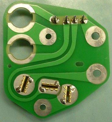

Thanks for the help. Does anyone make rebuilt circuit boards for the dash? I don't know that I need one just planning for the worst.
I pulled my dash out in my New Yorker, cleaned contacts, soldered burned traces in the circuit board. Those lights have never been brighter.

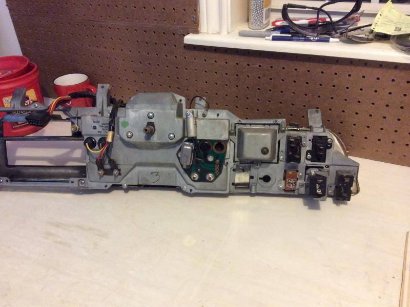

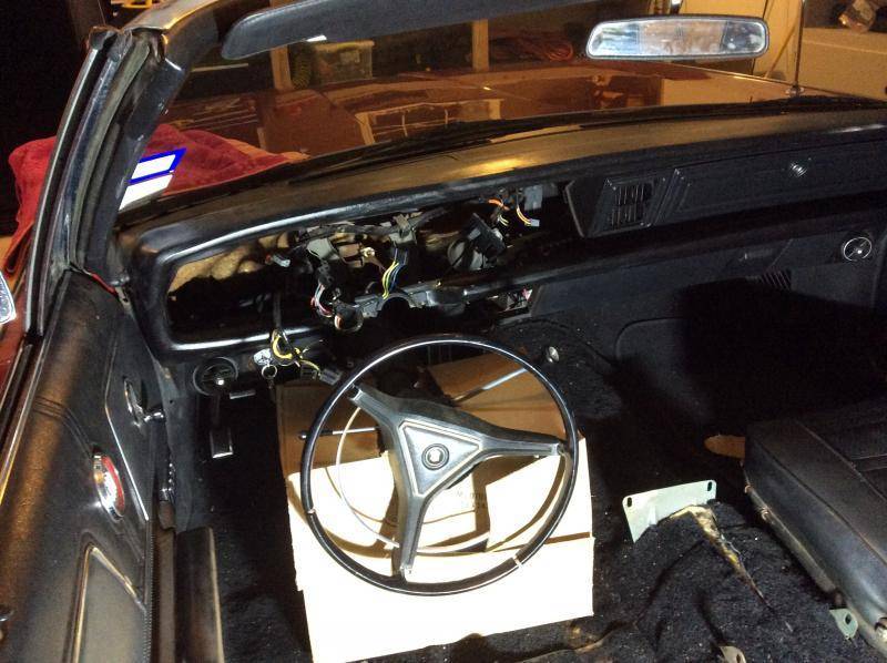

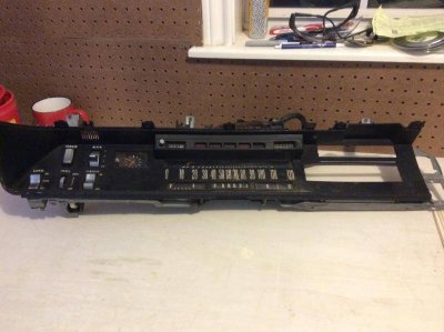

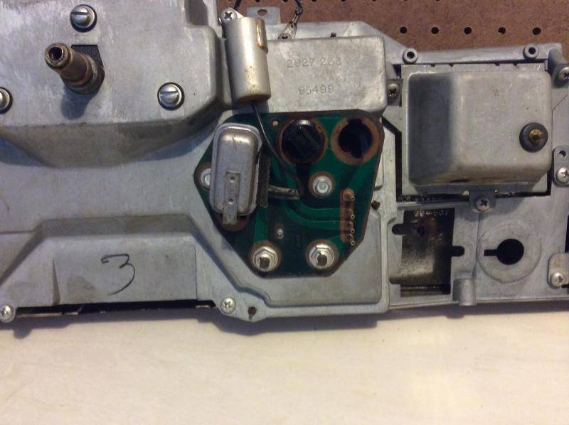

Is it normal to feel a bit overwhelmed at this point? Do y'all typically trouble shoot it on a bench with a 12 v battery or in the car?

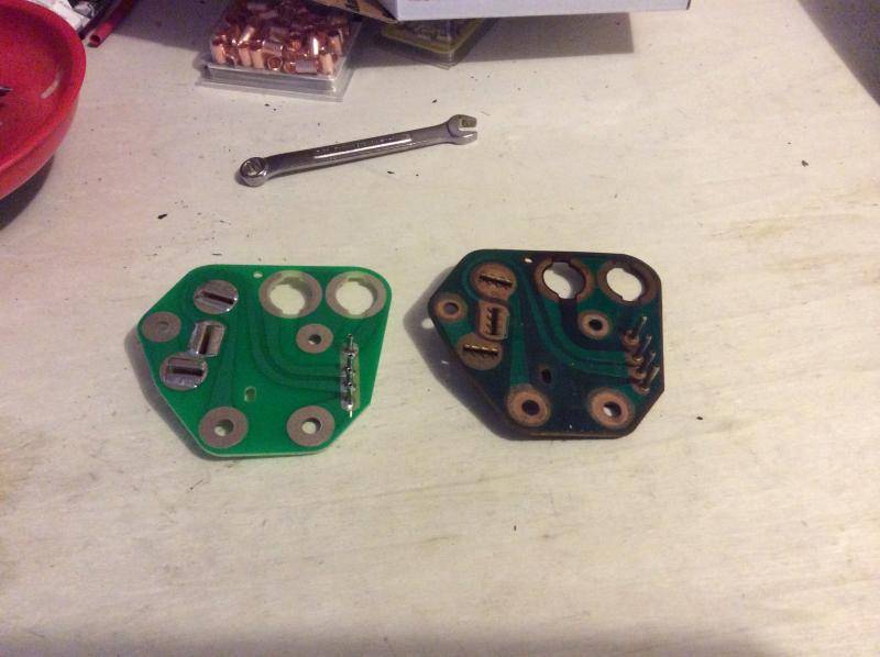

That circuit board for that one turn signal looks a little cooked....think we know the reason the light don't work.
Got the new circuit board in and it is a perfect match went in without a problem and the turn indicator is now working as it should.
