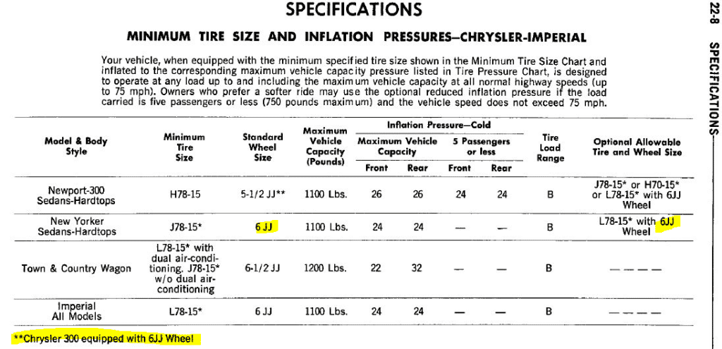

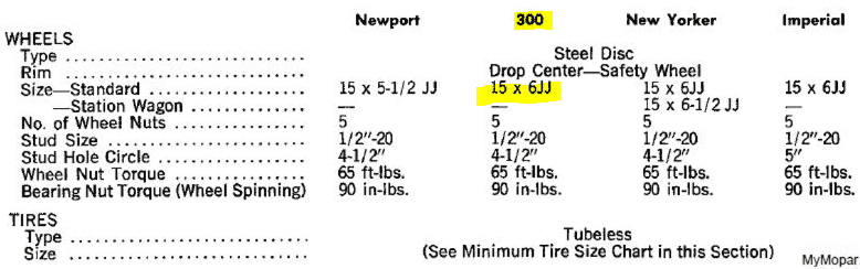

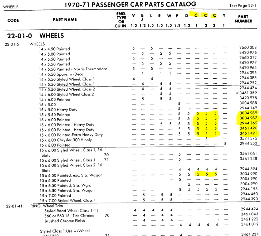

Question for the brain trust: What wheels are compatible with the 1969-70 Chrysler "deep dish" wheel cover? Will it fit on any 69/70 15x6" or 6.5" Chrysler wheel? Chrysler parts book does not indicate if only a certain wheel works with this hubcap. I've heard these hubcaps have limited wheel compatibility. Will they fit flush on 15X7 M-Body steel wheels? 15x7 police wheels? Any aftermarket wheels the will fit flush on (e.g. Wheel Vintiques stuff)? Thank you!
If the Chrysler parts book does not mention particular wheels for particular models/wheel covers, or referencing particular wheel part numbers in the wheel cover illustrations in the parts manual (i.e., "Not Compatible with wheel part number _______"), I would suspect it was a non-issue? Even less for the 15x7s.
Just some thoughts,
CBODY67
