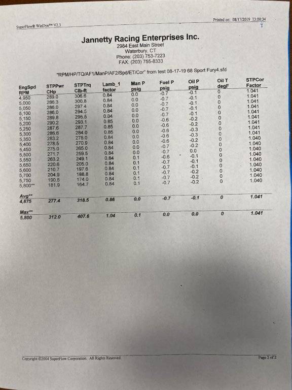

Engine Shop Dyno Runs after rebuild 05/2022
Holley 750, Open Headers – 437hp@4900rpm/573tq@3000rpm (Engine shops carb)
Carter 4640S, Open Headers – 420hp@4900rpm/550@3000rpm (My carb)

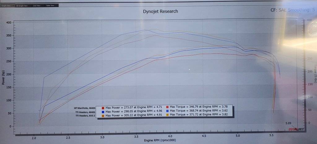

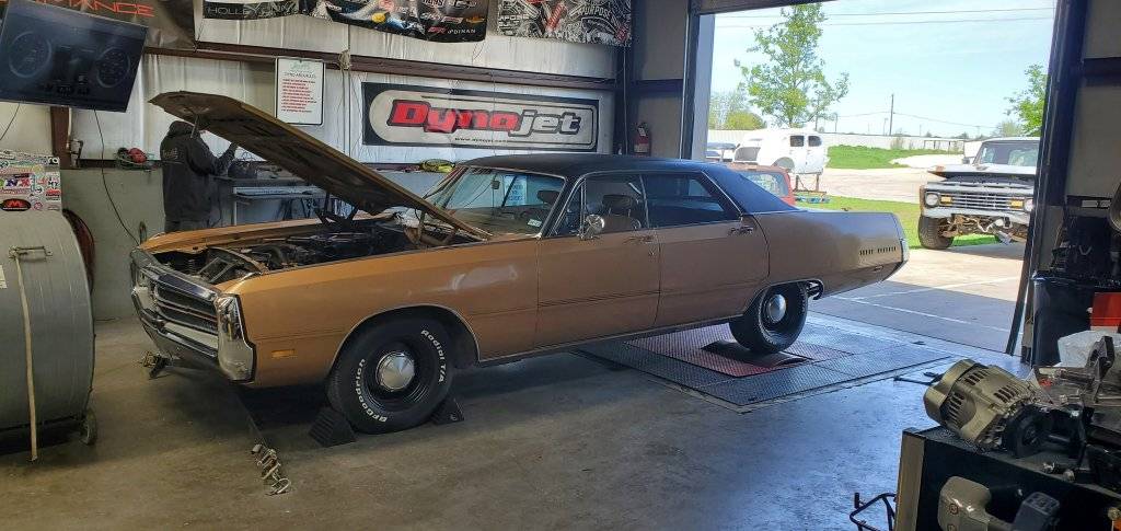

Dynojet Chassis Dyno – HP Exhaust Manifolds
Runs were made in 2nd Gear (1.45:1) from 2000rpm-5500rpm to avoid any down shifts. Not sure if 2nd gear skews the numbers up or down?
Carter 4640S, HP Exhaust Manifolds – 273hp@4900rpm/327tq@4300rpm
Without Air Cleaner --------------------- 278hp@4700rpm/347tq@3800rpm
Dynojet Chassis Dyno – TTI 1-7/8” Headers
Carter 4640S, TTI 1-7/8” Headers – 293hp@5000rpm/365tq@3700rpm
Without Air Cleaner ------------------- 298hp@5000rpm/369tq@3600rpm
Dynojet Chassis Dyno – AVS 2 Carb 800cfm
I made several runs while tuning the carb, changing rods, etc.. HP & TQ only fluctuated about 5 points between Rich & Lean.
I also modified the Air Cleaner and opened it up around its circumference. Little to no difference with it removed.
Edelbrock AVS 2 (800cfm), TTI Headers – 305hp@4900rpm/375tq@3800rpm
So, at the end of the day a gain of approximately 30hp/tq.
