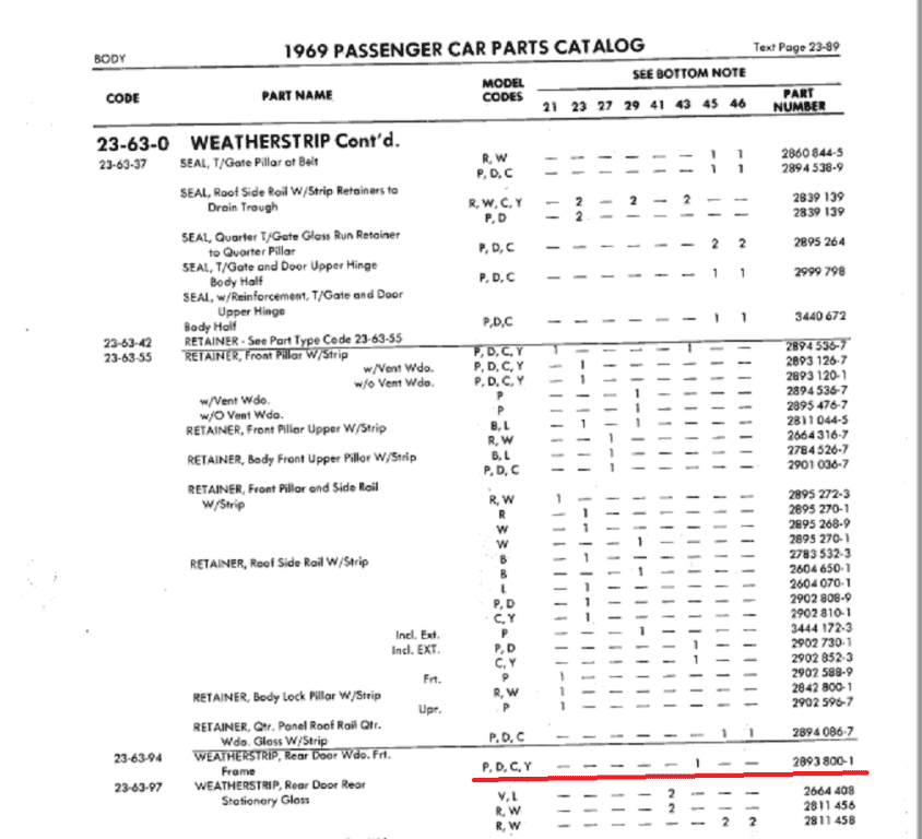

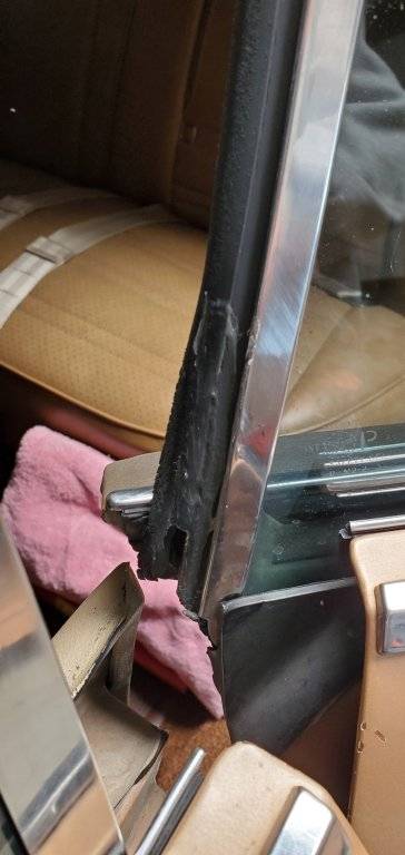

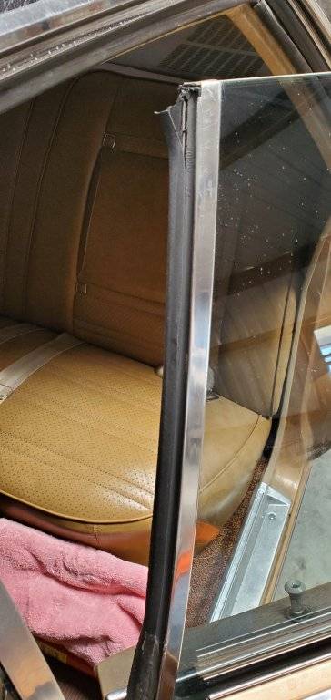

69 Chrysler 300 Four Door Hardtop, is there a part number for the rear window forward seal or must you find a complete window? Is the part number for a left or right?
Uaually, those weatherstrips are replaceable. They are a tight friction fit, which will pull out and then the new one is slid into the same channel. Right and left will be different.

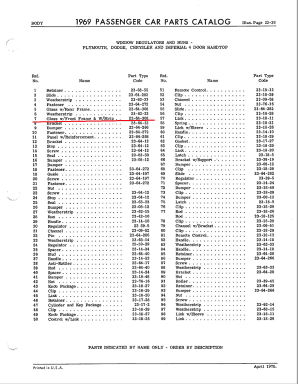

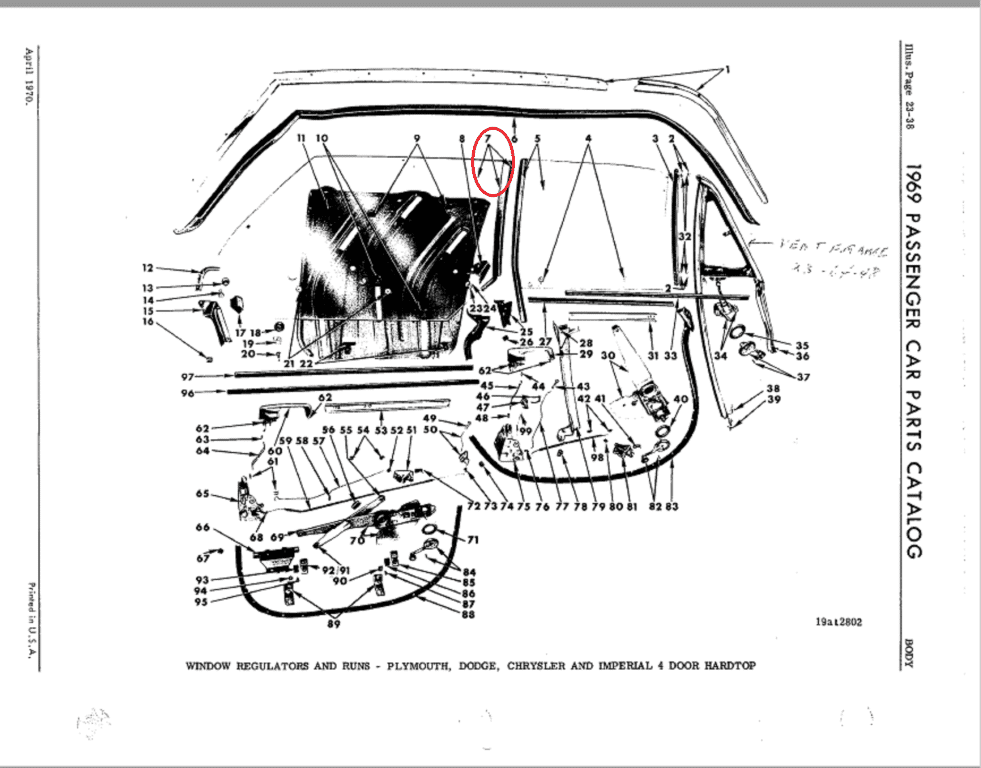

Should be in the parts book. Look near or in the same group as the chrome molding.

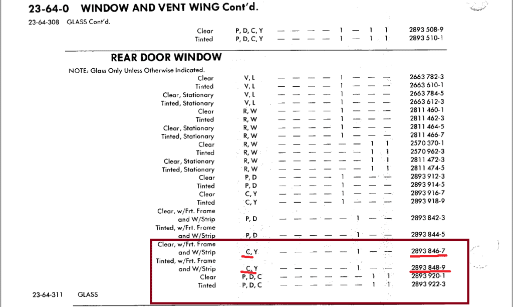

I actually found it by dumb luck scrolling, but didn't find the diagram that would lead you here. If anyone has a set, I'm interested.
