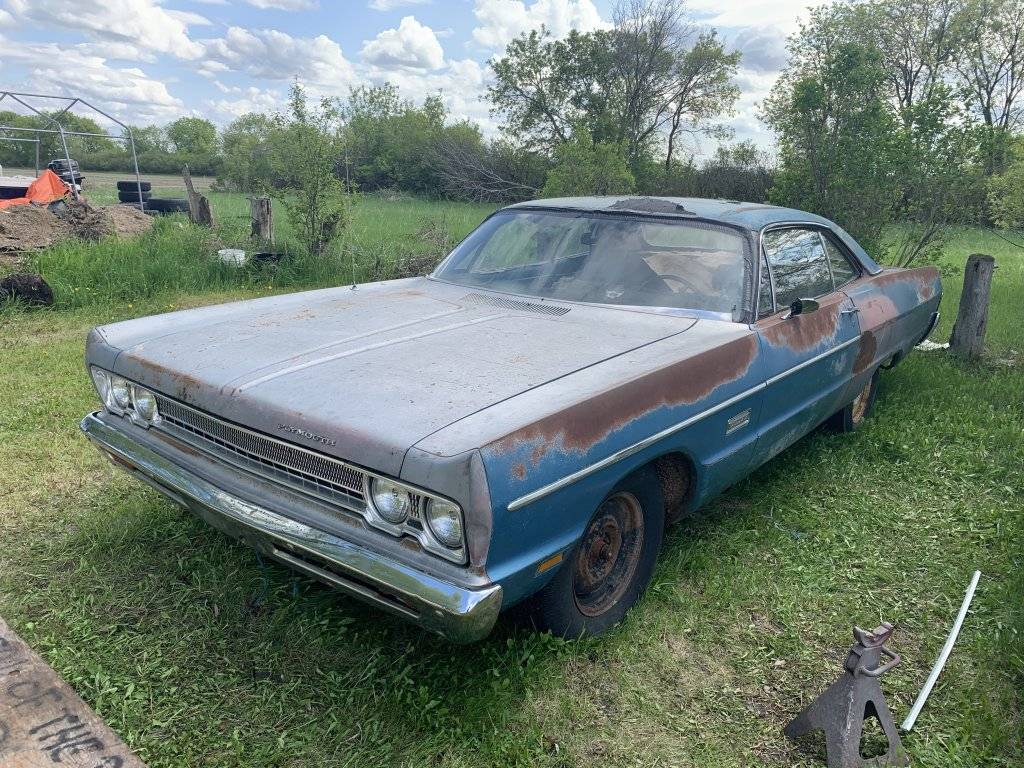

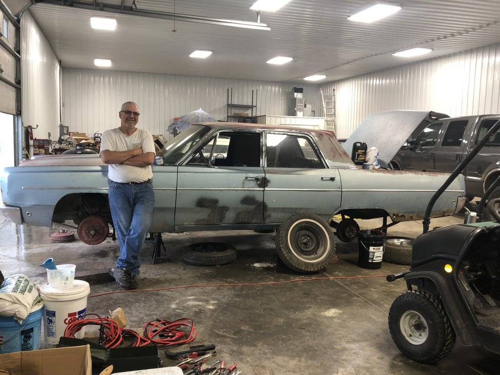

Started with a rolling chassis no motor or trans. Put in a 400 with a 727. Originally a 318 car. Got it running and driving with all new brakes.

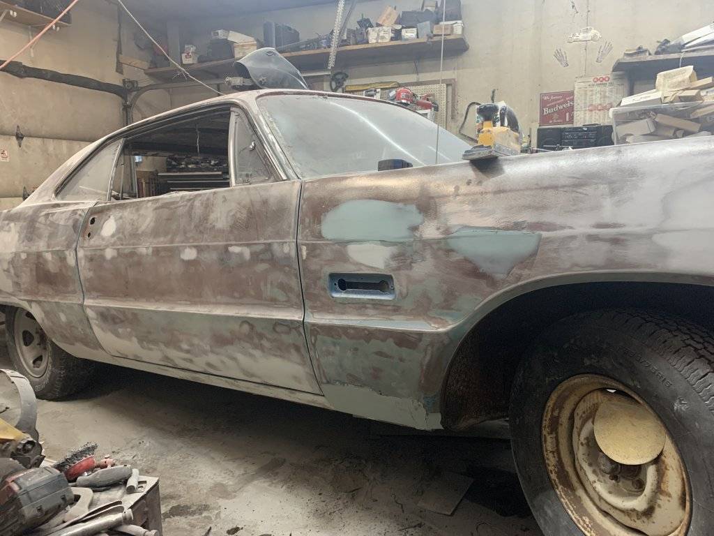

Original vinyl roof car rusted out the rear and front window trough, and trunk floor.
We replaced the window trough with new metal and cut out a trunk floor from a parts car.

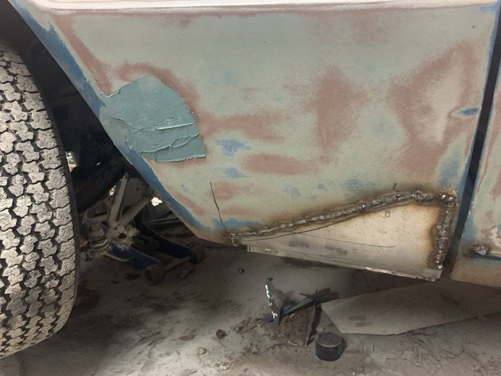

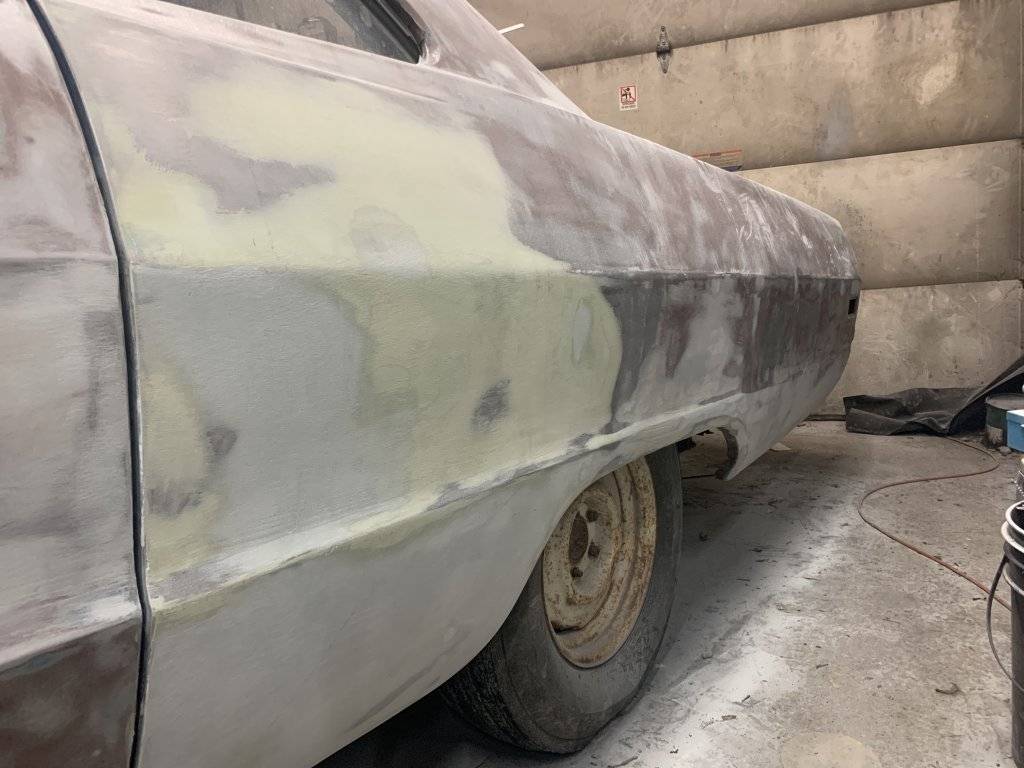

Just finished up doing all of the other rust repair. Home made lower 1/4 panels and front fender rust.

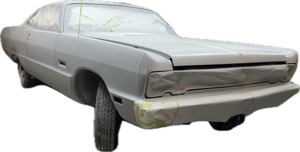

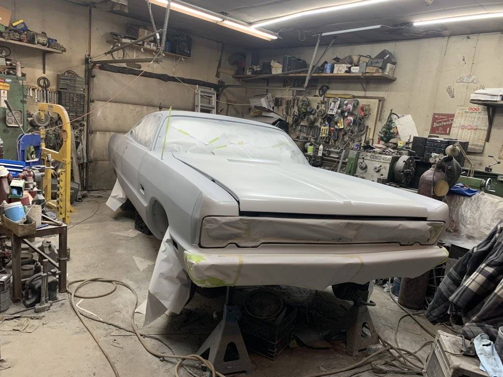

Getting it ready for the first primer coat soon.

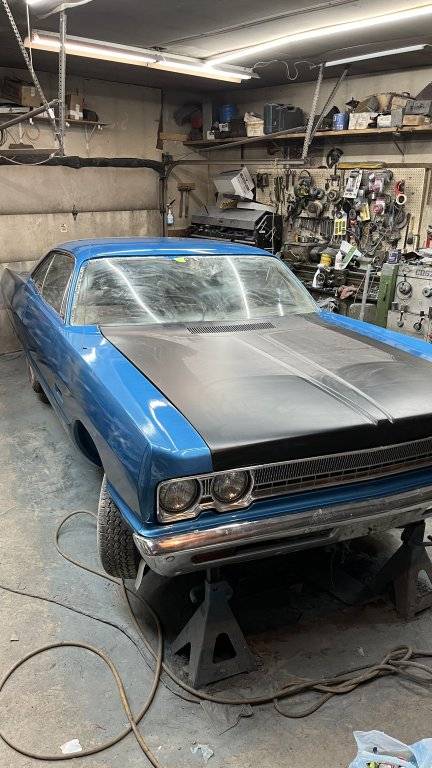

The last photo is why it will be a ratty c-body.
