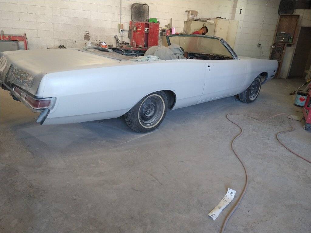

Yes it's mine, the paint on it was far from acceptable and there were some flaky repairs. The taillight probably have dust on them, doesn't matter as I have NOS assemblies.
The dutchman panel was the worst of it, when I took the car by my body guy he tapped on it and it sounded like a snare drum with metal rattling. I crawled in the trunk and spotted lots of rivets so i got the grinder out and went at it. After a 1/4" of bondo I got to metal.
This piece was riveted in.
As I moved towards the center it didn't get much better. The patch was lifted to expose more metal riveted in.
Under that there were three brackets riveted in
After all that was removed I was able to get in there and clean it up.
That will be tricky to fix and it is seen from in the trunk.
Aside from this the only rust found was on the front right floor and very little there.
