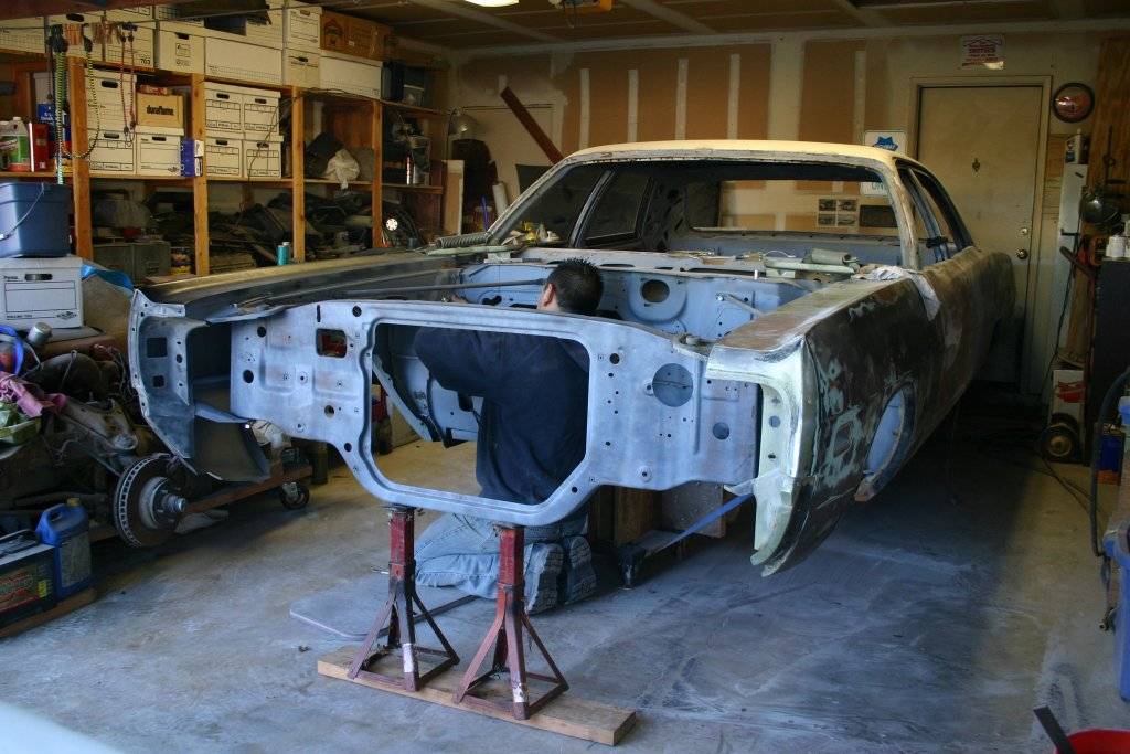

Saturday at 10:12 PM #4 MrMoparCHP Old Man with a Hat Joined Aug 9, 2013 Messages 6,044 Reaction score 6,242 Location Lompoc, CA polarnj said: Hmm once you take the grille out you can reach behind the front corner? Click to expand... You probably need an extension, 1/4 drive will probably be good enough with a deep socket. A nut driver may even work. I just checked and I could reach the nuts with my hand with the grill in reaching in between the grill and the core support. Alan
