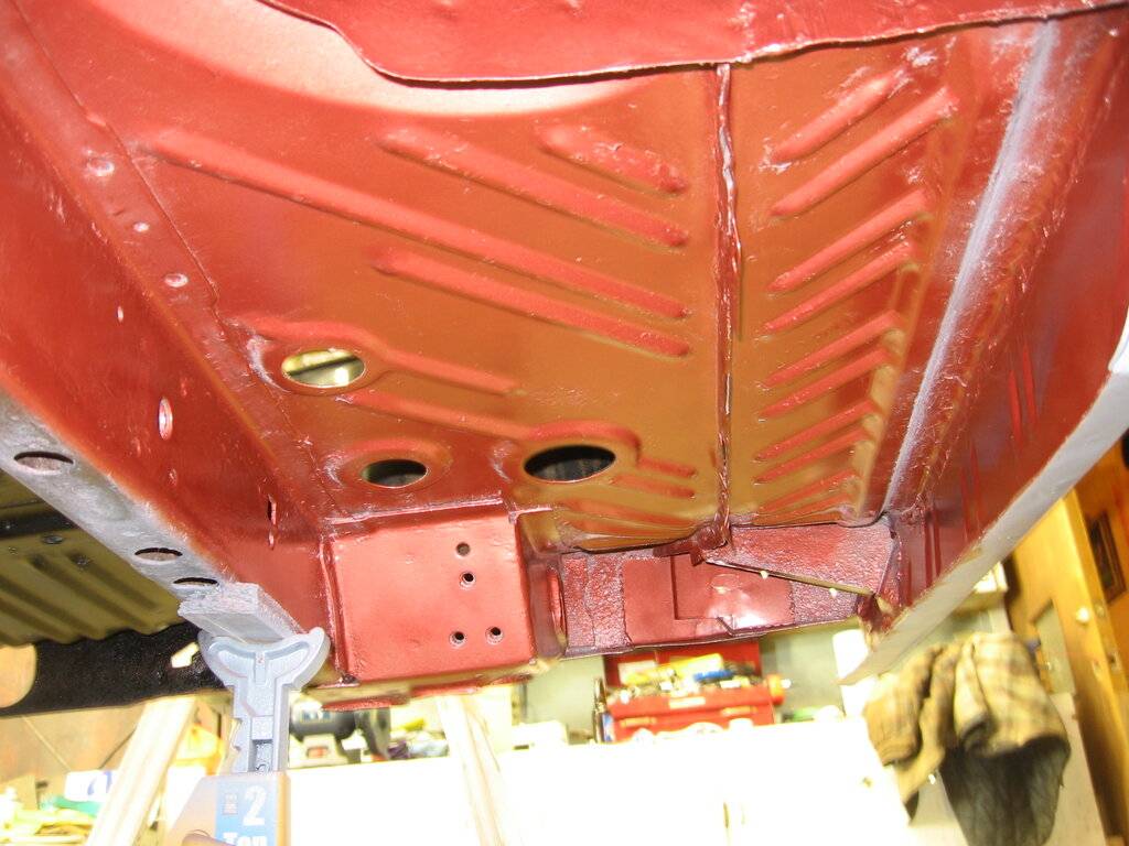

@cbarge made some for his car that looked decent and looked pretty straight forward to build. Perhaps he can post some pics of the process or link the thread.

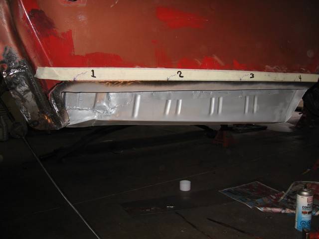

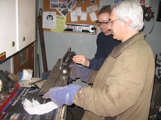

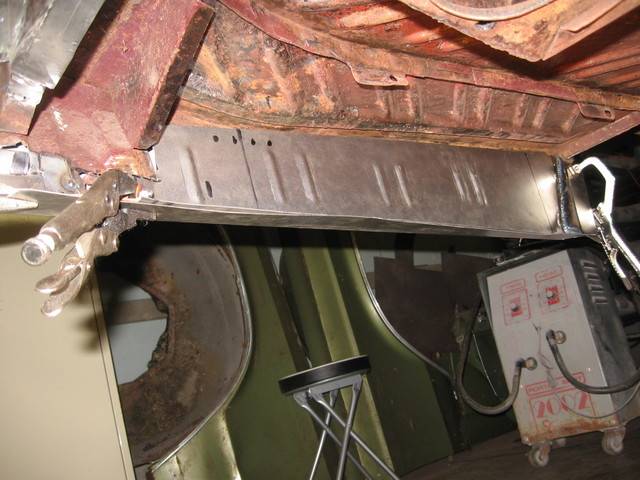

Thanks John..Gladly obliged..
20 gauge sheet metal was used.
Borrowed a bead roller to make the dimples.
Of course I had help from my friend Ray to do the welding.
Lots of weld-thru primer,buf/grinding discs,trial and error.
Once welded into place,I seam sealed the joints and epoxy primered everything before final paint.
Nice work Cbarge.!!

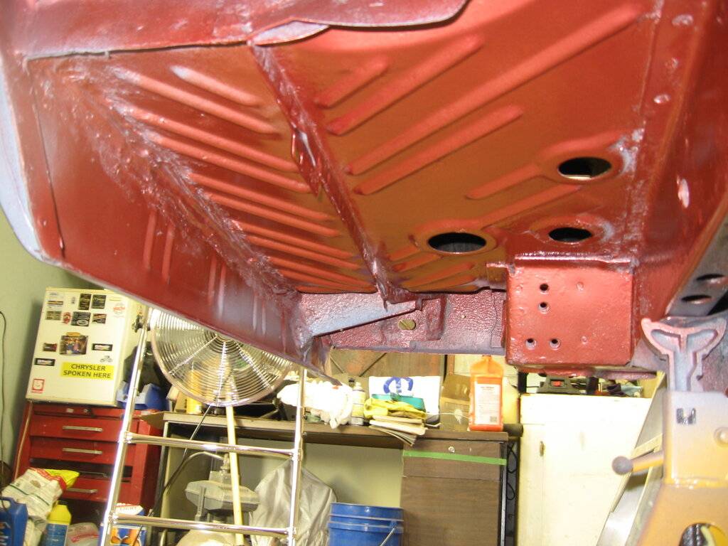

Davews,the if the drop down looks to be the same as 69 polara and you can use them? There yours for free+shipping. I will get some pics tomarrow of underside.
I'm in the middle of cutting 300 up and will be no problem to just zip swazall across.
Nice work Cbarge.!!

My bad, I forgot about cutting these off 300 with holidays and all. I will try to cut them out soon.
Should be easy enough.
Thank you sir.... and no problem about the delay. I totally understand the Kaos of the Holidays...
