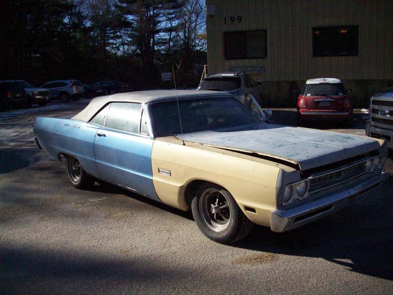

Well I am in the early stages of planning to strip down the Sport Fury and start to get it ready for necessary body and paint work. I want to get some of your expertise and ideas on stripping off the paint coats to bare metal. I am looking at stripper which is very time consuming messy and of course caustic. Sanding which is dusty, messy and time consuming. and then there is soda blasting and or media blasting. Any ideas ? thoughts ? information ? Pro's / con's. I went thru this already with my last Sport Fury that I had and it was done over a six plus year time frame and sorry to say as some of you know it was all for not !! :BangHead: OH well life goes on and now it's a new project all over again with a whole new project and I am sure or at least hopeful with less rust issues to start with.

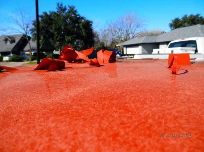

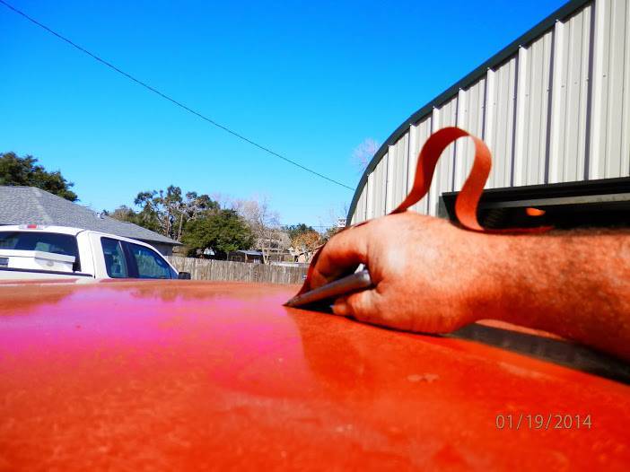

It looks like factory paint. If so I (was shown by a paint and body man I used to work with) strip it all with a razor blade. Works great. Does take some time but won't remove any of the metal and doesn't stink like hell.

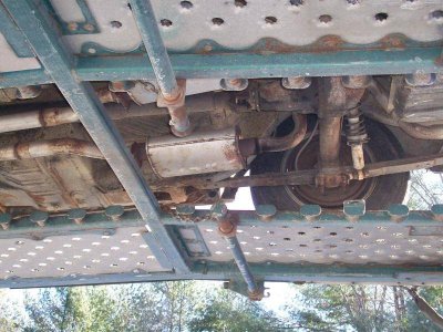

I had my '70 Fury Pursuit done approx 10 years ago for $700. It was all painted surfaces but nothing underneath. A couple of months ago my '66 Toronado was done only on the underside. They removed bunpers etc and painted the suspension etc chasis black for almost $1000. Take your car or pics or email them to the media blaster for their opinion and estimate You underside looks pretty good so they should be able to do a great job. If choosing a auto body shop they may have recommendations who to send it to and even a discount.

I know the nose is primer over sanded original paint, the doors seem to have several coats of paint and the *** end seems it may have also been repainted as well I will see better as I start stripping off the trim and stuff. I have two brand new NOS front fenders with one coat of copper color paint which I will strip back down to bars metal then paint. As for the hood ??? that is an issue as I will be doing some modifications to it however I may need to locate a better one to start with.

I can't imagine how this works!? Without any chemicals :eusa_shifty:
But seems to work..! I have to try that on my car. I know I have the factory paint on it!

X2...I did this last year on my Firebird, saved a lot of sanding time.
