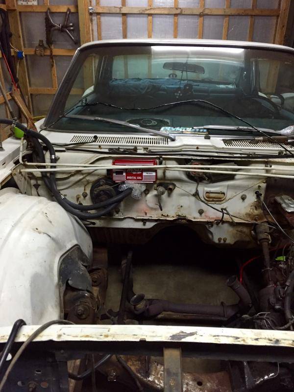

Looking for some opinions on where to mount the 6al. This to me seems like a good spot, but I'm not sure if the hood spring bars will be banging on it. Where have some of those of you have them or have had the put them?
I never mounted one on a C-body myself, but I would look on the radiator support (facing the engine) rather than the firewall. It will be a little cooler there.
I thought about moving the horns and putting there.mmmm.
Lotta room up front and that coil won't care if you hang it horizontally or vertically or in front or the back side of the core support. That'z why Gawd helped man invent Uni-bores and cute little rubber grommets.
I never like mounting electronic stuff on the front side of the radiator support. I'd rather they were quite as exposed to rain etc. Probably won't make a difference... but that's my preference.
If you do mount it vertically, mount with the wiring facing down. That helps keep water out.

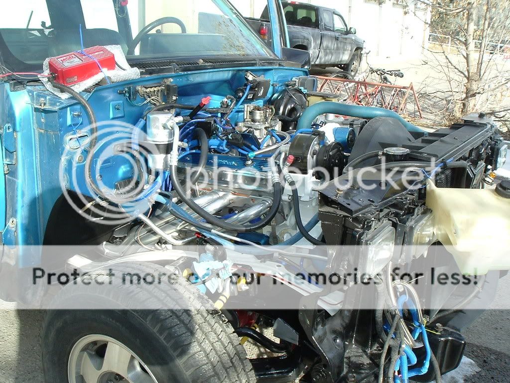

use one in my 91 gmc..good units for basic cars...mount with wires down as stated above...this will enshure rpm tabs at bottom where water cant pool...
depending on car would throw in trunk or dash area if possible rad sppt area bad idea due to possible water intruision...if you don't care if its seen throw on top pass side inner fender or fenderwall
