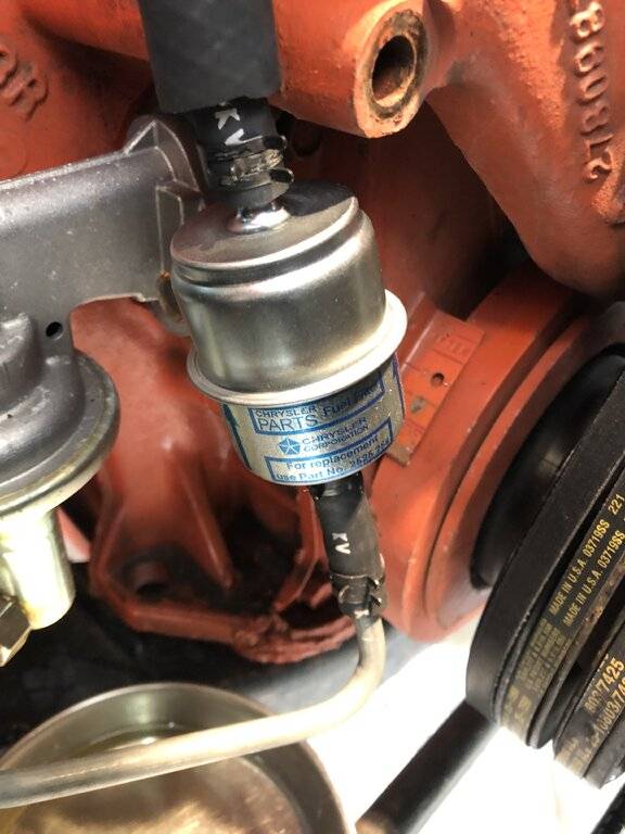

The fuel lines on my recently-acquired TNT 'vert are all good, except the fuel pump needs replaced and the current one is incorrect (and so are the pump-to-carb ones). I have bought the correct Carter pump (M4845) and am ready to order the 2-pc DBE6805 lines for it -- but I wonder about which of the above clamps and clips are needed for those two lines (and how many). Please advise!
I have bought the correct Carter pump (M4845) and am ready to order the 2-pc lines for it -- but I wonder about which of the above clamps and clips are needed for those two lines (and how many). Please advise!
1. On the suction side of the pump, I use a modern worm hose clamp to totally prevent the sucking of air at that connection. For that matter, I incorrectly use worms along the entire main line from tank to pump for that same reason. Vapor lock is not our friend, and sucking in even a tiny mouse fart of air will do that.
2, No clips at all to hold the DBE6805 fuel line in place are needed. It supports itself, but you probably already knew that.
3. If you buy this correct fuel filter, it comes with the correct, and annoying, Keystone hose clamps. Factory Style Fuel Filter Dated April 11, 1970, Fuel Filters, 102-F1010 Reproduction, NOS and Used Mopar Muscle Car Parts. Or, you can cheat and go with four of the easier 5/16 spring clamps like I did as show below. The split rubber hose over top of the 5/16 fuel hose is to prevent chaffing against the water pump and prevent a little heat transfer to the fuel. The alternator blocks the view of this little cheat from above.
4. If you're using the OEM AVS, the tube screws into the carb inlet. In my case, since I was using a Street Demon, I used a 5/16 spring clamp where it might show (under the giant air cleaner housing!), and a worm at the carb nipple. Ignore my finger. It's not pointing to anything other than the fuel line for some other Inline Tube question I posted to a year ago.
