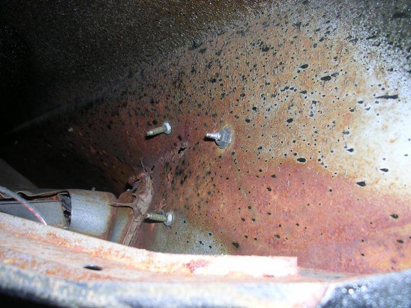

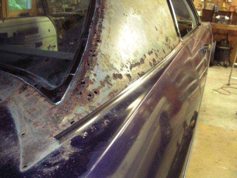

I want to remove the stainless vinyl top trim at the bottom of the c-pillars and near the bottom of the rear window of a 70 Fury 29 body. Anyone have any instructions for doing the job or pictures of the clips that hold the metal strips in place?

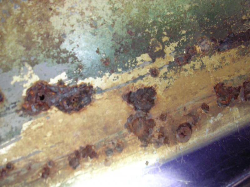

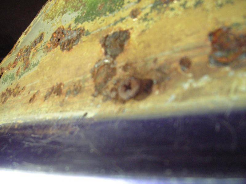

Update
