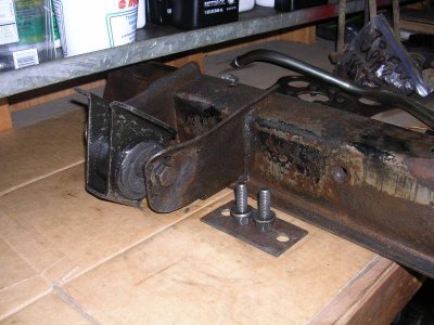

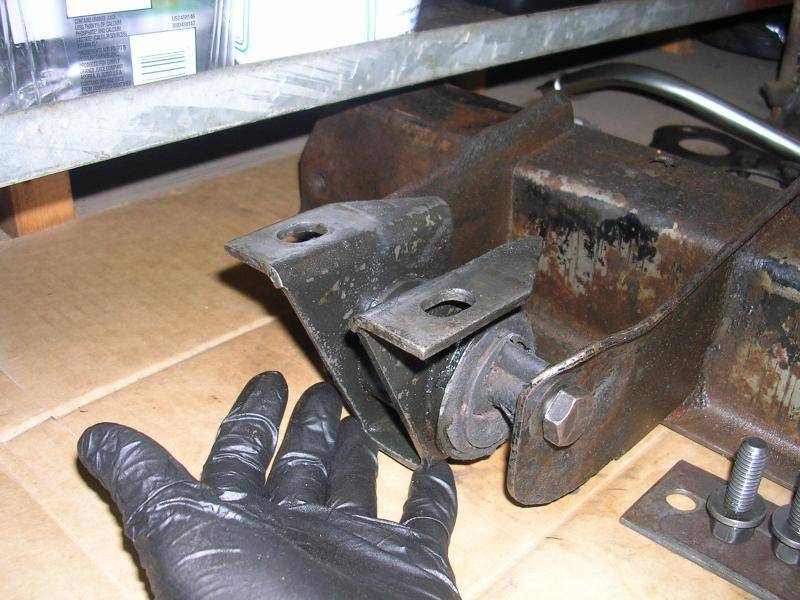

1970 Fury III 727, 904, and Driveshaft
Hi, I'm doing basically the same swap on a 1970 Fury III except 318 to a 440. On the driveshaft and front yoke, I found that the 727 extends about 3.5" further to the rear than the 904, so your 904 driveshaft has to be shortened to work. Also, I found that the external diameter of the slip joint at the back of the trans is 1/8" wider with the 727 than with the 904. Finally, the 727 front U-Joint/yoke is likewise 1/8" wider than the 904, so you would need a conversion u-joint to make a 727 front yoke work with a 904 driveshaft. In short, since the front slip joint, front yoke, and driveshaft are different, and the 904 driveshaft is light duty, you may want to consider a different driveshaft for your 727. My 904 driveshaft is probably going to end up in recycling when the time comes to actually pull the drive train. Hope this helps, Ben
Note: please make your own measurements, all the measurements above are rough approximations.
As far as the trans mount, I took some pictures of a 1970 727 mount yesterday. If it looks the same as yours and you need measurements of some kind, I'll try to provide them.
Thanks, good pics. I can get that mount from Schumacher, looked just the same. Been a little quiet now, car came from the body shop and it didn't go so well. A big issue finding the matching color, couldn't find it so the car is a two-tone car now..
