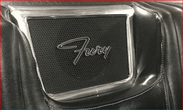

Here is vinyl tape/wrap on my sedan insert I converted to convertible insert. The inside corners have a few wrinkles which with better quality/flexible vinyl wouldn't be there. They dont even make the vinyl I used anymore. I was concerned it would not stick under heat of the sun so I used some generic contact adhesive first. Been working fine since 2013!
Went you dont have your convertible rear seat speaker grill
Thanks. Looks good. I might go that route.

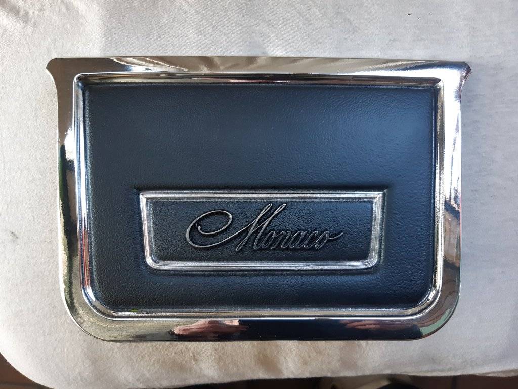

I have either an NOS or VGC seat insert matching the above image but have to continue to look for it. It might have been mis-boxed but is in a factory box and marked appropriately w/padded paper wrapping around it but will either way continue to search for it. The chrome is light-years ahead of the above but has some light scuffing to it. (per your question the perimeter band is chrome) Either way it is not the right one for my 71GT.
