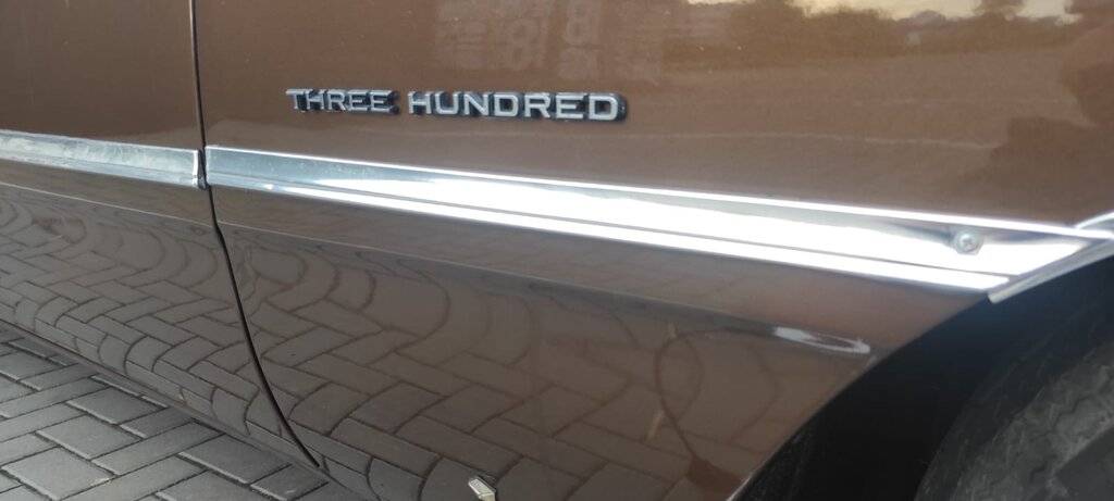

Hi. I want to find out how to find and replace vinyl trim molding on a 1971 Chrysler 300. Do you know anyone? Thank you for your time.

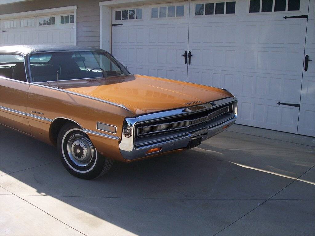

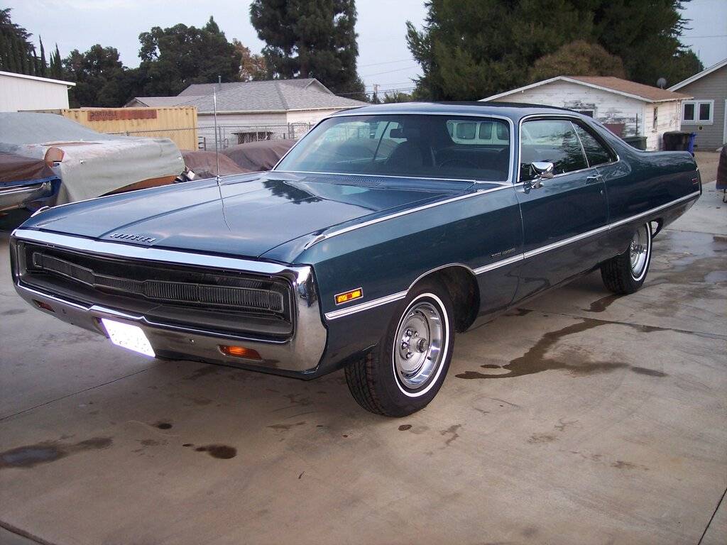

I used that technique on this car that I sold recently to Austria.
1971 Evening Blue Metallic Chrysler 300

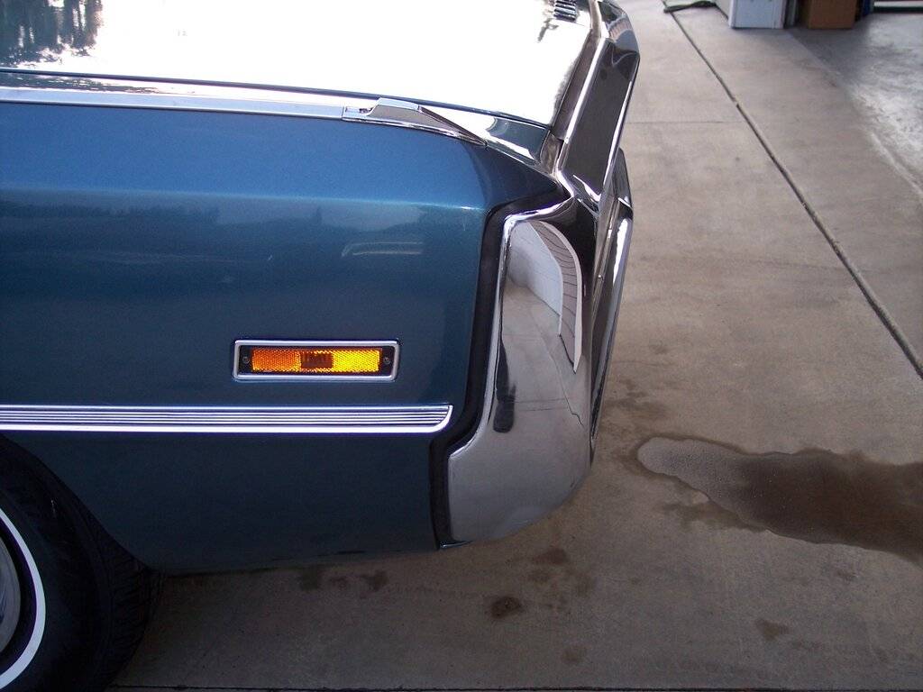

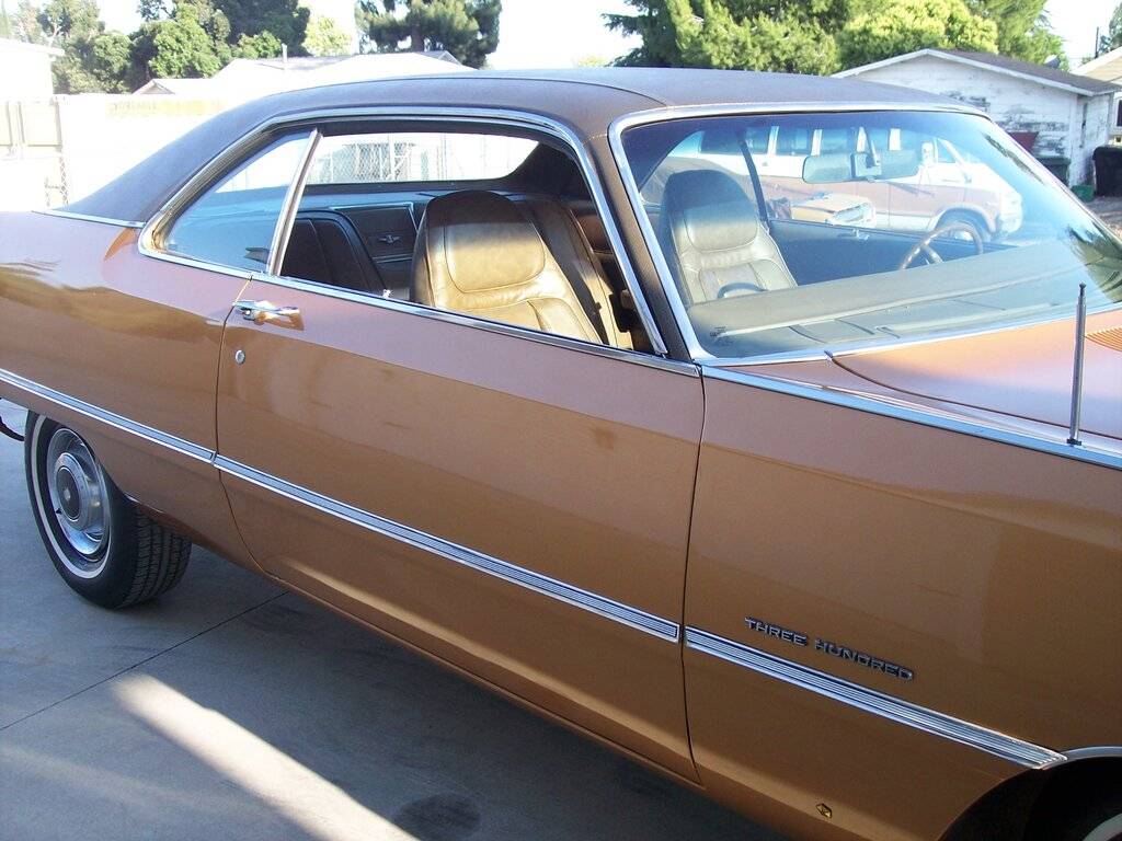

Here are some photos of moldings on that car and another one I sold more recently. It was very hard to tell the difference between the moldings on these cars vs original ones. I used vinyl spray paint so it would adhere best. I keep my cars in a garage and don't drive them in poor weather.

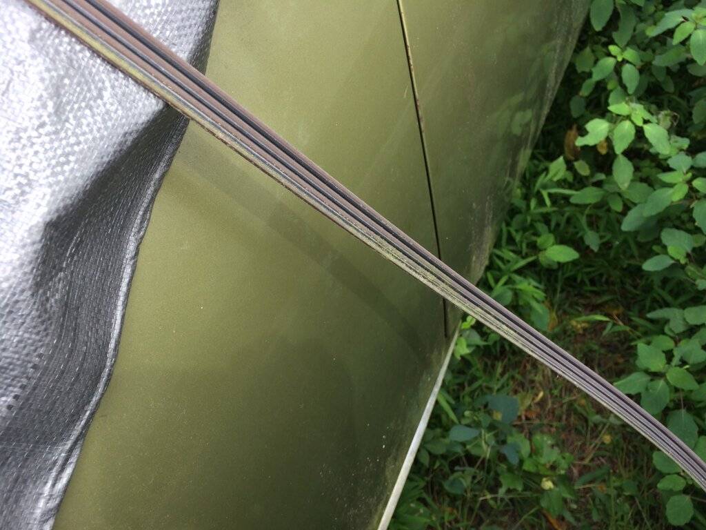

Don't give up on me yet. I'm just a little slow on getting these photos up for you.
Here's what I have. It's a little dirty, and probably a bit faded, but I think it will clean up, and maybe a good coat of vinyl preservative will bring it back to life.
Looks like you need enough to do your door and fender. Are you missing it in any other spots?
Jeff
Thanks for the offer. Nice to find. I'm in no hurry. I'm happy for every meter of this vinyl. I only have two original moldings on the passenger side (rear door and rear body part).
The code on that factory label in front of the battery is V5T (TAN).
You're missing a lot more than I expected. Almost every piece of trim.

You solution did work out great. I don't think that I would have noticed that they weren't original, even up close.
Jeff
I took a closer look at how much vinyl insert is left, and it's not nearly enough to replace what you are missing. Unfortunately, someone ran a bunch of screws through the insert on the passenger quarter. The driver door only has half it's insert and the rest is missing.
I think your best bet would be to try Steve's trick.
Maybe he can post an example of the type of vinyl flooring that he used.
Jeff
The Gold car sold a couple years ago now and I recently saw it in person. There was no change in the appearance of those restored moldings from when I made them - i.e. no fading of the colors or any evidence of starting to peel at all. I was pleased to see that since the car is running around in Southern California a lot. The owner loves driving it everywhere he can.

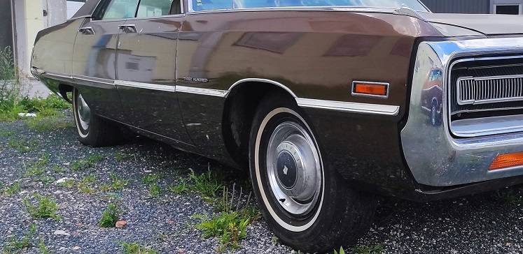

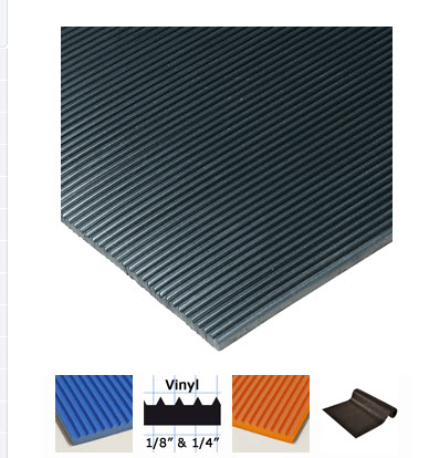

I looked at American Floor mats and I don't see any SN-730. Would VCVR be the correct current item? 1/8" thick mats up to 150' long. 1/4" and 3/16" thick mats up to 75' long.
While the item number seems to have changed, that is what I am using in my 71 300s. To be sure though, maybe you could ask the company what the difference is between this latest offering and the original 730 mats that I used. In the past, I do not recall them having anything but black ones, so having various colors now is a plus to more correctly match what your car originally had. It is somewhat of a chore to get the colors in the groves but I used a felt tip marker pen to do it and you can see in the above photos from my previous posts how they turned out on a couple of my cars.
Perhaps you could show us a photo of an original section of your trim on your FQ5 great looking 300 to see what the original ribbed sections actually looked like since the body code plate does not delineate that.
