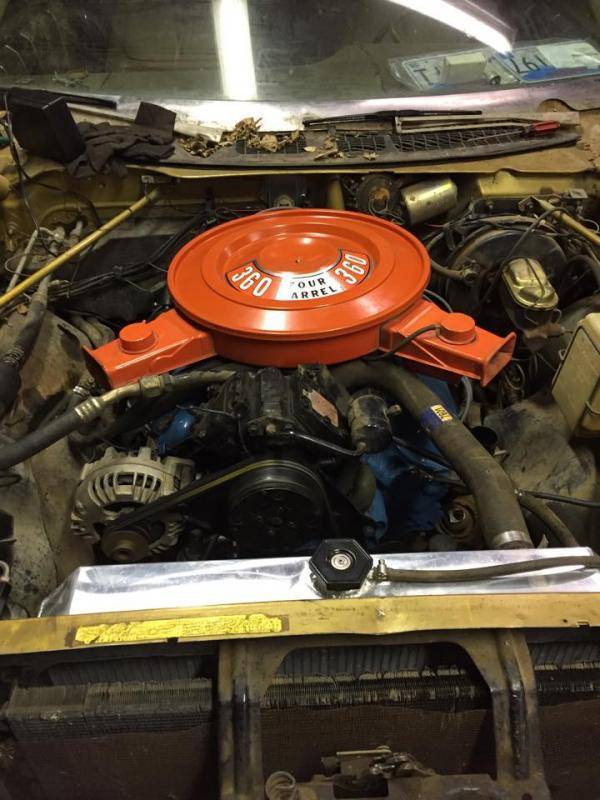

][/QUOTE]I am so excited. She runs like a top. I put a non-sure grip 3.31 gear in the 8 3/4, 340 cam, Holley 600cfm carb on the original 360. Rebuilt 727 with shift kit and 2200-2400 stall converter. Just waiting to get it in the shop for dual exhaust. I purchased an H-pipe, and decided to try the Cherry Bomb Vortex Turbo mufflers. I took the air filter off a 72 400 we have in the shop, and added the 360 4-bbl sticker.

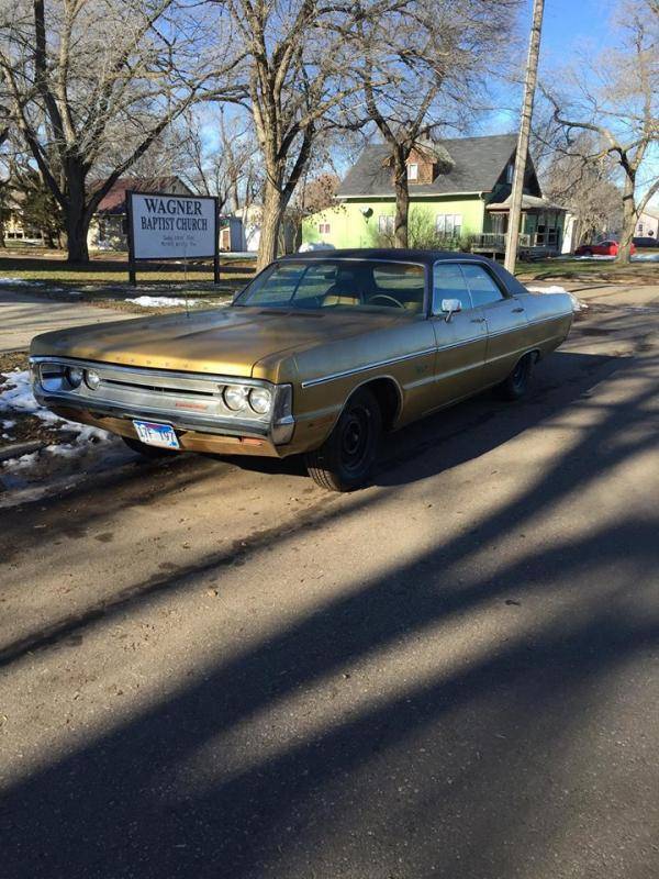

That picture was taken in-between snow storms. We have snow on the ground now. It does handle well on the icy roads. I put the deluxe hub caps on it last night.
