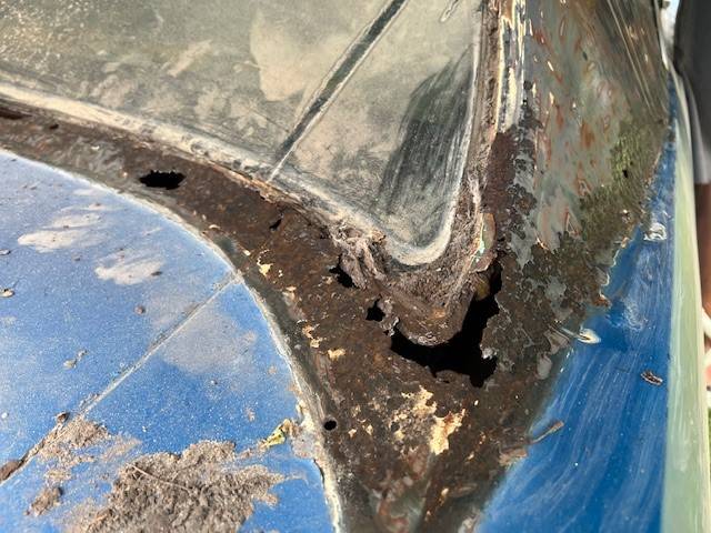

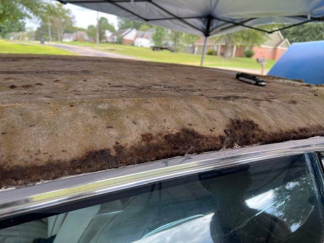

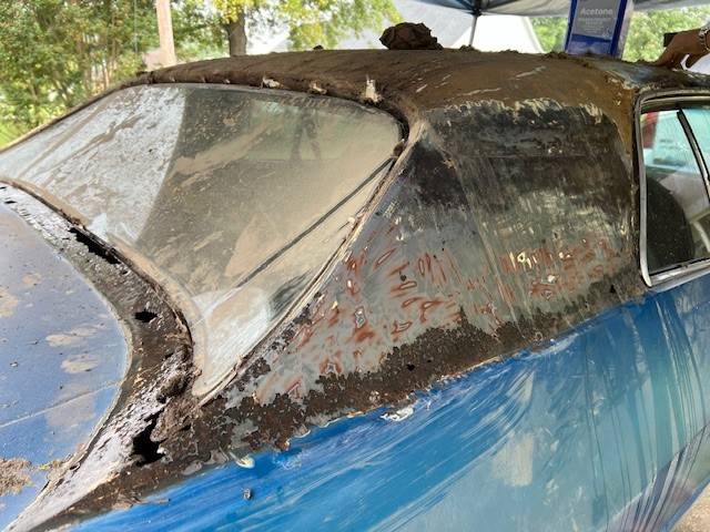

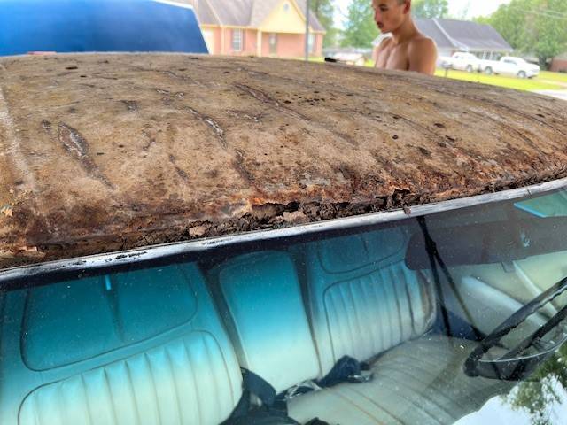

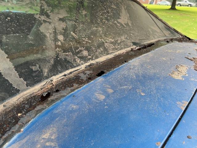

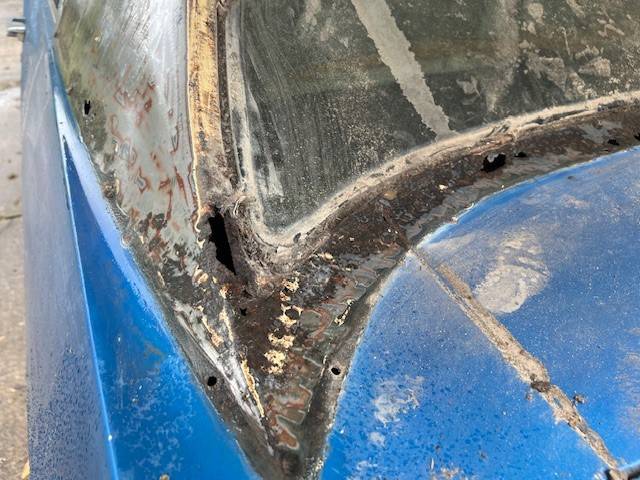

Well, my son and I finally got to the point to remove his vinyl top. Was hopeful that it wouldn't be too bad, but not good. Looking for some options you all may have done to address the types of issues we are seeing. @FURYGT here are the photos we were talking about last week.

I would get a good roof from a donor car. I changed the roof on my son's 74 Barracuda and his was not as bad as yours. If you can weld, it was not too bad a job. Trying to fix what you have will be a never-ending battle. If your plans are to just use it for a while and get rid of it, you could clean it up the best that you can and epoxy the holes.
You will need a good donner car to repair this. Premo fab skills need here otherwise. If sub structure rust is found the donner car can supply those parts.

That’s pretty bad. You would be better off buying a parts car with a 29 style roof that never had a vinyl roof. Before you tackle the roof, I would do a thorough inspection of the car for additional rust damage. I would be shocked if the trunk floor was not Swiss cheese. This way you can determine whether it’s best to purchase a donor car or to purchase another car in better condition and use this one as a parts donor. Very sorry to see that much rust.
MIght look inside the car, too, as mentioned. In the C-pillar internal areas, the turnk pan, and rear floor pans. Everywhere the water from above could have gotten to on its way toward the ground. Taking out the interior will be necessary.
As the roof is a structural part of the body, all of that "gone metal" means the body is weaker. Any project to replace the roof would mean the body has to be supported (on a flat floor!) on about 8 jackstands. Two under each side of the rocker panels, two for the front stub-frame, and two for the rear body/bumper crossmember. That would keep the body from collapsing when the top section is removed from it.
There might be some attraction to the existing car, but the reality, to me, is that the car you have can be a donor car for another car whose engine and transmission have been removed from it. A car with a better roof and hopefully never had a vinyl top covering on it.
Just some respectful thoughts,
CBODY67

There are times where you just have to walk away and find a better car. I'm not saying this is the case here, just suggesting a step back to look at the big picture.
I had a 1970 Sport Fury 29-body, vinyl top, perforated roof. Mine became a donor for my 1970 Fury Convertible.
Look for structural problems like rot in rear subframe

It could be possible that the vinyl top being left on kept some of the water out. If the rest of the car is not that bad, I would do a roof swap. It looks like you would need the roof and the panel behind the roof too. I was never a fan of vinyl tops and never bought any of my cars with them. If you have decent welding skills and can do a little bodywork it is not that bad. You would need to remove the front and rear windshields and measure everything to make sure all the tolerances are correct. I measured mine multiple times and made a diagram (easy for me, I am a retired illustrator). There are also several YouTube videos you can watch. Whatever you decide, good luck.
Thanks for all the replies. You all have confirmed my thoughts about addressing this. My thoughts have been donor car to either replace current top and rear quarter; or, use his current car as the donor.
Surprisingly, floor and substructure are in very good condition. Trunk pan is in very good condition as well. However, trunk extensions are toast and severe rust to lower portion (lower 3-4 inches) of rear quarter panel.

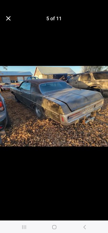

So I might be able to help out after all I should be picking this one up soon. I'll get some good pics of the back window area after I get it home.
Thanks and let me know what you find. Definitively at a point pushing my knowledge base. Have several friends locally who are very experienced and willing to assist my son.
