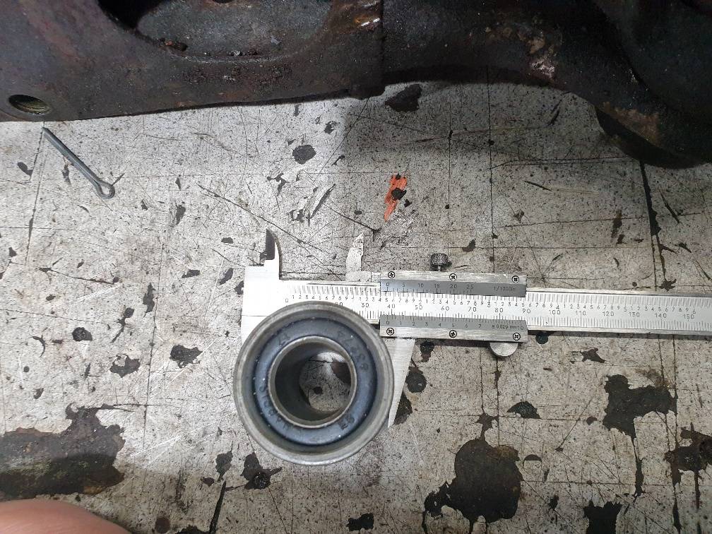

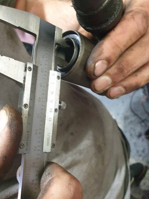

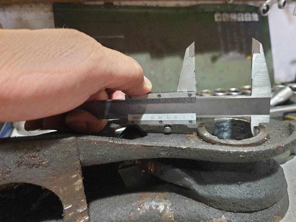

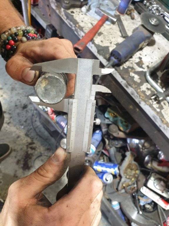

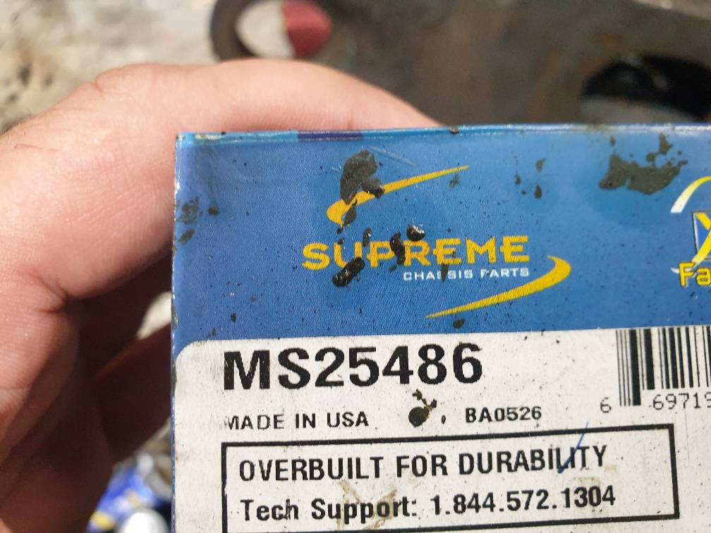

Just to clarify by some pictures about the LCA bushings for the 73 Imperial.
Supreme MS25486 didn´t fit.
outside diameter: 38,45mm = 1,5137795in
- but needs 39mm (=1,53543in), therefore it can´t be fixed/pressed in.
Is there another TRW-No. maybe or something like that?

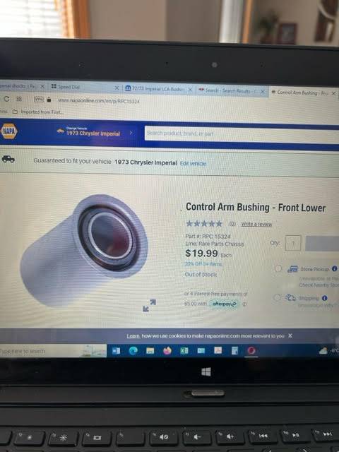

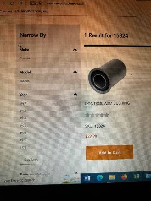

Hi Moseman,
This may be old by now. I clicked your Napa link and I came up with part number RPC 15324. The note on the top indicates "Guaranteed to fit 1973 Chrysler Imperial".
Went to Rare Parts website and it states 15324 is applicable for 1967-73 Imperials. I put one in the cart and no indication it is NOT available.
If Rare Parts is correct, LCA bushings for 67'-73' Imperial's is looking to be hard to find as Rock Auto has no LCA listings for those years. I did contact Moog and they indicated that if enough people would fill in the form to request this part, manufacturing would consider making a run order. I am going to request what number of units they would need to consider making an order.
