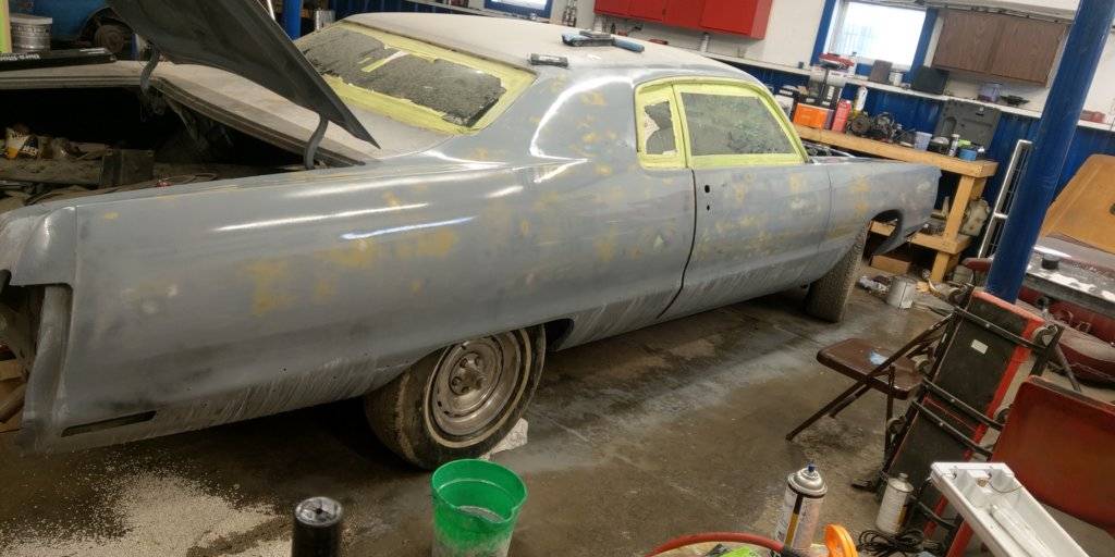

New to the c bodys, currently working on a 72 new Yorker 2 door. What are these cars worth? Hard to find a 2 door for sale.
Don't have to many pictures yet

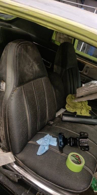

I don't want to sell just trying to figure out value for my reference and insurance in the future, I'm currently setting it up with Holley throttle body efi, blocking it out and painting it black, and I need to figure out how much it will cost to get the seats redone
I guess while I'm posting If anyone has any seat covers .. . Or else I'm going to try to just get the fabric redone

For the seat fabric, seek out an "old line" trim shop that has the "DeLeo" or "Detroit" fabric swatch "parts books for fabrics/upholstery". These books have the original swatches AND part numbers for the OEM seat upholstery. Vinyls and the fancy brocade-style fabrics used back then.
In some respects, it might be best to re-use the vinyl sections, just replacing the fabric portions. Notice, too, the French seams that Chrysler used and be sure the shop replicates those. A more expensive and better way to do things.
Unless you find some "new production" fabrics, then the fabrics you get can be "NOS", which means they are the same age as the car, which might also mean a certain amount of dry rot is at play (although they look new). Similarly, the "oils" in the vinyls can evaporate with age, making it more brittle. Some coatings/refurbishers can help prolong its life, but not a "protectant" per se. But do start with a good cleaner that cleans and conditions it. So you might inquire as to the age of any fabrics your shop gets.
Reason I mention the "age factor" is that in the '80s, a friend had a '66 Cadillac he was using as his family car (with two small kids). He wanted to keep it "stock", so he went to the trouble (more back then than now) to get the orig fabrics for the seats. When it was done, it looked good. A year later, it was in pieces. I asked "What happened?" That's when he mentioned the dry rot situation. So, having seen that, that's why I'm mentioning it.
As a note on shopping for an upholstery shop, you might inquire with new car dealership service departments in your area to see where they send vehicles for warranty replacement upholstery repairs. This can ensure that the shop knows what OEM Quality Work is and can do it. Even if the dealership orders in new ready-made covers, they still have to be installed to look like when the vehicle left the factory. Same if they do a "panel replacement" too. Might look for a shop that does "leather upholstery upgrades" to non-leather, late model vehicles, too. Key thing is that your results look "like it left the factory yesterday" rather than have wrinkled seams and such. This search might take a bit, so don't hurry.
