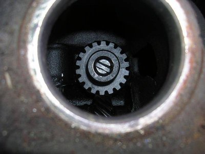

I agree with big john. I don't know what engine you have, but some of the teeth on your oil pump/distributor driveshaft could be toast. That would cause distributor to turn unevenly. See example of 440 driveshaft with OK teeth below. Did you ever get the distributor out?
