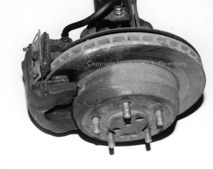

On the 74/75 Imperials with rear disc brakes, are the rear brake calipers mounted ahead of or behind the brake rotors? Anyone have service information on this system? Are the same calipers/pads also used on other applications?

Caliper mounting depends on which side of the car you're on. The Passenger side has the caliper on the trailing side; on the driver's side, it's on the leading side.
Imperial Rear calipers are the same as the front calipers on a Volare (F/M/J cars up to 89). Pads are the same, but the steel tab must be modified on the outer pad (ground out) to clear the rotors.
They are very hard to find parts for, which scares a lot of people away from these.
Nearly impossible parts to find list:
Rotors, Emergency brake shoes (fit inside the rotor "hat") and spring hardware. Rear hoses (the stubby ones).
They are worth the trouble to keep working in my opinion...my 74 Imperials are the best braking cars I've ever owned.
So a drum brake conversation is doable as a Hail Mary Save in a worst case scenario.
