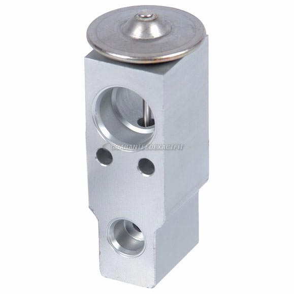

Perhaps someone can help I got a new expansion valve today and it has a few extras that I can find with my old one. It has two round plastic things that look like they could be inserted into the diaphram. I suspect all the o-rings are for the hoses & fittings which I already replaced.
I've tried to find a specific diagram w/o any luck
http://www.carsteering.com/data/all_images/EX-EX10154C-700-Map.jpg
I already got it, just had these strange plastic things in the kit....but I think now its to keep stuff out of the lines before they get replaced. I found out I need 2 gaskets for the lines on the compressor, they apparently don't put them on the new units under the blockoff plates.. The bolts are a bit short for the hoses too. Boy its sure going to be nice when I have cold air.
