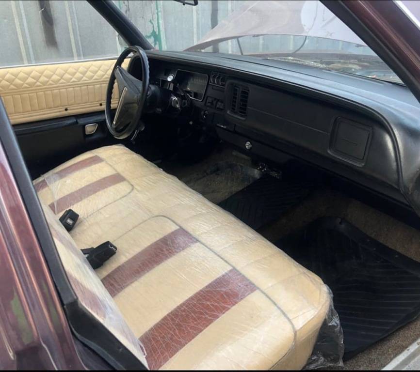

- Interior door panels (in a daily driver or better condion) and/or bench covers of the same tone if possible.

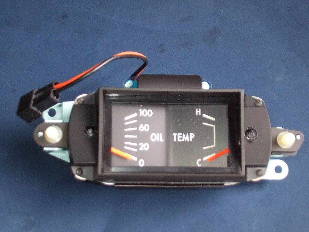

- dashboard airvents - to the left of the steering wheel (btw, could someone tell me please which device in this configuration is superfluous and not stock?)

what colour interior parts ?
Unfortunately, the original colour and design of upper parts of door panels/seats were changed by previous owner. However the bottom part of the panels is still black and looks original.
Since I will have to change the cover of benches to something more original and less pretentious, I will consider panels of any tone in good condition. If you have the same color of bench covers - it is interesing too (well, I didn't check the construction of the benches yet and not sure that there is such a thing as covers on them:confused:) Thanx.

the lower double gauge isnt stock. looks like an air vent has been removed and its been added.
this is the optional combination gauge :

Thanx, marko. The image is really helpful.
Definitely, I would love to return the stock vent to its place. If anybody has one, please let me know.

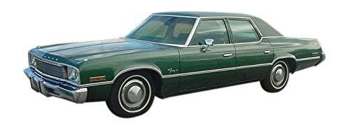

Using the opportunity, I would like to specify if Fury I has the side/waterline body trim/moldings. My car has no side trim currently.
Am I right that Fury I doesn't have the side trim at all, the Fury II has the side trim and the Fury III has the side trim + chrome arch moldings + sometimes Brougham package in a form of moldings installed at the bottom of the doors?
It seems that this image presents the full set of possible trim except the brougham package.
I'm just trying to figure out how my vehicle could look like when it rolled out of the factory and what part of trim should I look for in future.

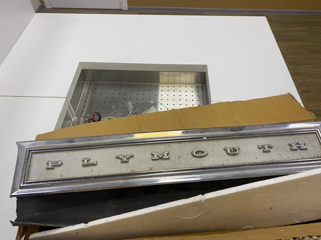

What about this plate? Is it a marker of the top level trim or something else & optional? The most of the 74' cars I saw were with the simple steel/plastic plate and not the chrome one.

Fury III or Gran Fury. You can see in the pic above that the Fury I and II trim level had a Plymouth script on the painted gas filler cover.

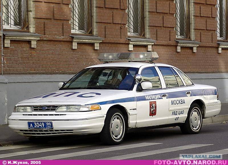

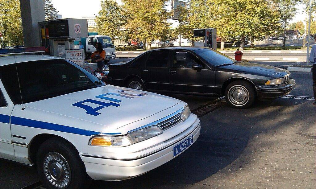

in the 90s Crown Victorias were officially imported from US for Russian (mostly Moscow) Militia and were used as police cars for some 7-10 years.

marko, indeed FCV's were imported to Russia in 90's to serve as the police cars. Now the service of the majority of them is ended. The first part of decomissioned cars are sold to private owners, the second part went to junkyards. However, there still may be a few FCV's in Moscow that still serve. However, the last time I saw it was in 2014. Not sure what about today.

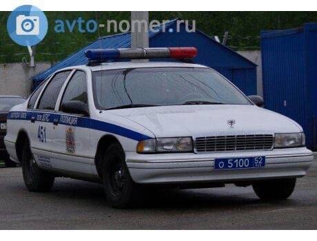

To add, I would say that in 90's other Russian cities have a few Caprices 9C1 as a police cars.
All Caprices are decomissioned as well from the service, however the most of them are still alive in the hands of the new owners.

The "Plymouth" trim piece for the gasoline door was not used on 1974 Furys. That was for the 1975-1977 Gran Fury.

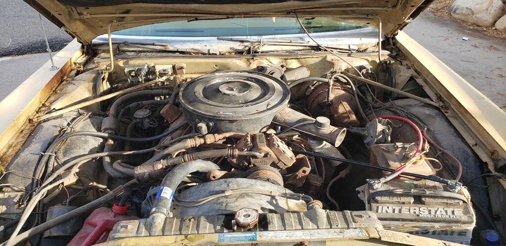

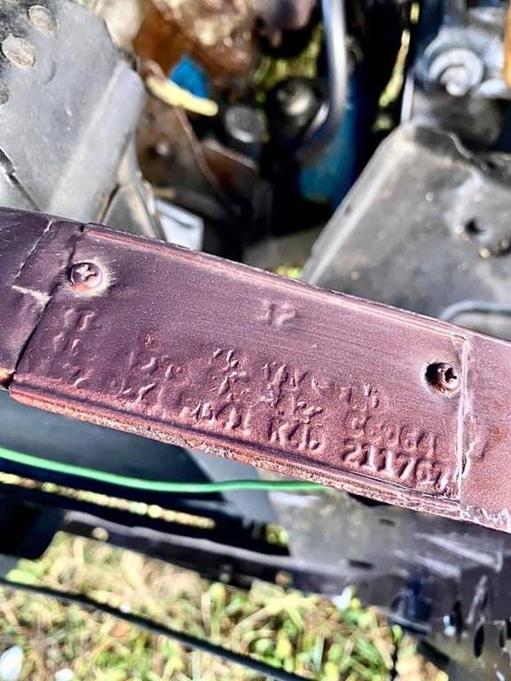

What is the fender tag? All I know that my vin has an L-letter which means that the vehicle has the lowest possible trim with no a/c.
In this example picture of a 1974 LeBaron:
you can see where the fender tag should be located also on your car: in the lower right corner in this picture. If it's not there anymore, bad luck. If it's there, please upload a picture of it and we can analyse the codes together. H41 was standard equipment, so even your PL = "Fury I" should have it. H51 and H53 were optional a/c installations.
Thank you for the info. As soon as I get to the car, I'll check the tag. However the car is not in original paint, so there are chances that it is under the post-original layer of paint
UPD: Well, the fender tag almost unreadable, unfortutanely.
I wonder if I can make it more readable using WD-40, carb cleaner or something like that.
