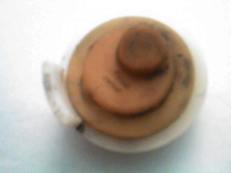

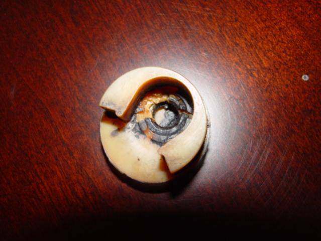

Tell me why a 78 formal is less desirable than a 76/77?
The #1 reason is the wiper cam. When it breaks there are no replacement parts on the planet....period. I've wasted a ton of $$$ on used wiper cams and they all failed. The final fix I used was using parts from a 1976-1977 NYB and cutting and welding a makeshift repair. The question with 1978's is when is the wiper cam going to fail, not if it will fail.
Wiper cam (used only on 1978 cars)
And the final fix that used the smaller wiper cam from 1976-1977
