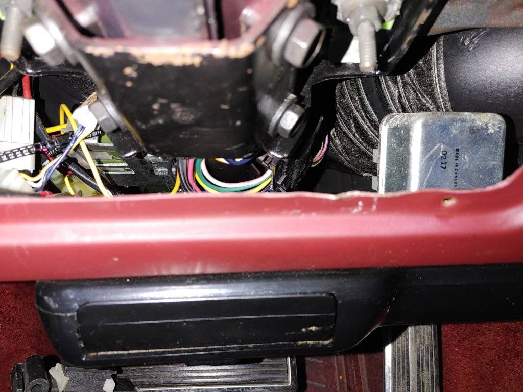

Hey y'all,
My turn signals went out the other day, so I figured I'd replace to flasher as a first step before I dig in any further. My hazards are working, so I suspect it's the flasher. I will be darned if I can find the bloody thing! I've been rooting around under the dash, pulled the trim panel off to see if it's behind there and having no success. I looked in the factory electrical manual but I honestly can't relate the drawing to reality. Does anyone have a pic I can use as a reference? Here's an attempt to show what I'm seeing.
Nope, that is just the black box full of AGC glass fuses and the big 60 amp(?) square metal fuse. I spent a lot of time wrestling with that over the winter, but that's another story. I really hate getting under the dash, my garage is very narrow so the door doesn't have a lot of swing for access.

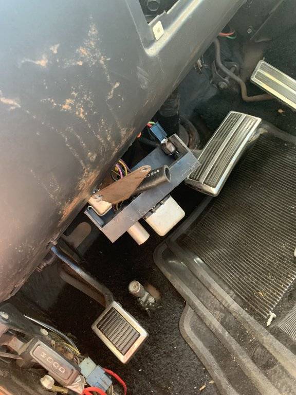

It’s under there.. to the left of the column but before the E brake lever. You may have to pull the knee / lower dash panel under the steering column get to it..
If I can get to my car I’ll post a picture for ya.
What I discovered is that with the front seat pushed back a bit, I could rotate and hang my knees over the seat back, with my shoulders resting on the floorpan, which gave me a solid and comfortable position in which I could gaze at the undersides of the instrument panel and concentrate on what I was seeing. At least until too much blood settled in my upper body and I had to get upright again. Better than placing my lower back over the rocker panel, by a long shot. That was when I was about 45 yrs younger than now.
I found an old thread via Google on finding it under there. Seems the fuse block has a different mounting that slides out on a bracket, or has a thumbscrew which allows it to swing out for better access? Both flashers should be on it, either side by side or nearby on it, typically.

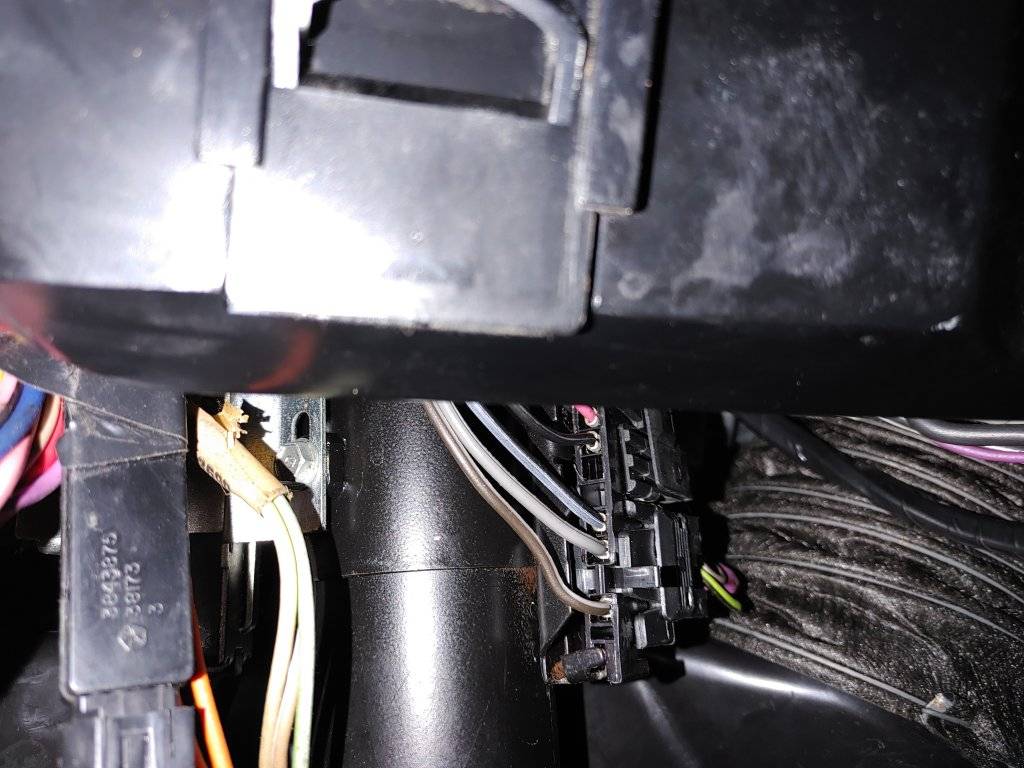

Wow, what a coincidence, I just had to replace mine last week since the right signal stopped flashing. Interestingly enough the left side still worked, I have no clue why the flasher caused that but it did. Anyway on my 77 Gran Fury, which may or may not be like the other C bodies that year, the turn signal flasher is located on a metal bracket near the steering column at the firewall, not with the block containing the horn relay and 4 way flasher under the dash. It's a very odd flasher, the original one was yellow plastic and it has a tab on top that locks into the bracket to hold it in place while a wire plugs onto the connectors at the base. I don't know if this feature is unique to police cars like mine or if they're all like that.
