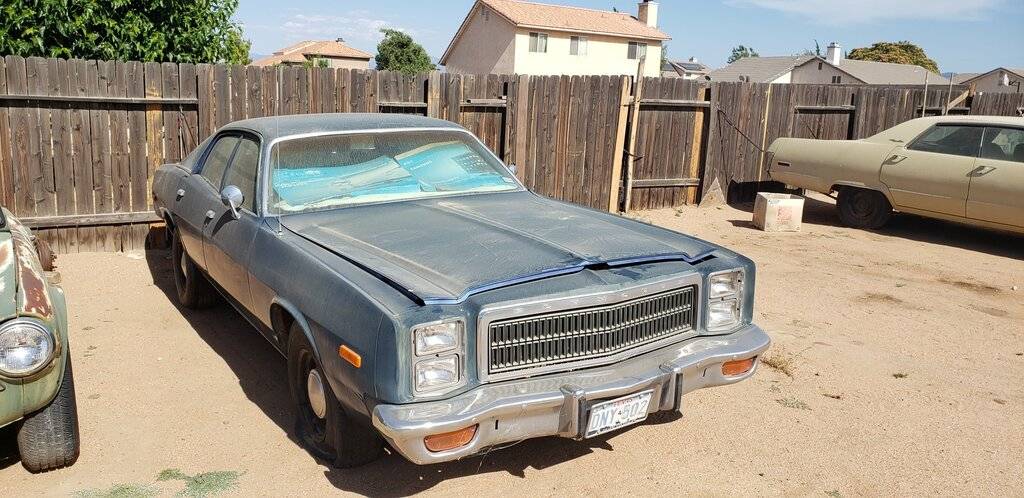

The tags are hard to read because of the paint. One tag said special handling car, what did that consist of? 360 2bbl engine. Thanks
Special handling usually consisted of heavier rear springs and shocks and special police only torsion bars on the front. Some cruisers also had a different boost ratio for the power steering. There was also an LA series handling package that had a shorter pitman arm and different steering linkage to shorten the turning radius on some models., I am not sure if that was still available on a B-Body cruiser in '78. To increase frame stiffness, some cruisers also had additional spot welds on the rear frame rails and additional support for the rear cross member. Special tires and wheels were usually also included. You would have to find the build sheet to see what all was included on your particular unit. That era of cruiser will usually have the build sheet stuffed into the top half of the rear seat cushion under the springs for the cushion. With a 360 2BBL engine, this was most likely a city police unit.
