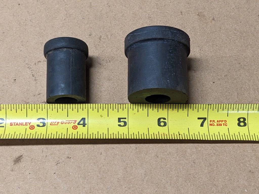

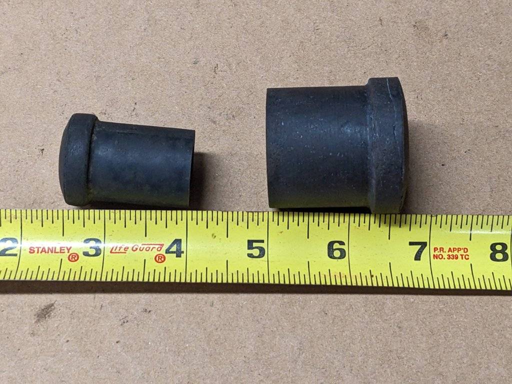

Comparison of the 1" and 1.5" bushings:

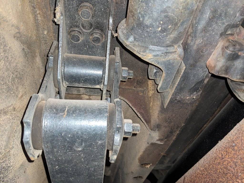

R-bodies used the 1.5" bushing in upper and lower positions. The following image shows 4050083 installed in my 1979 Newport. I purchased these at Chrysler and installed ~1993 and ~130000 miles ago.
