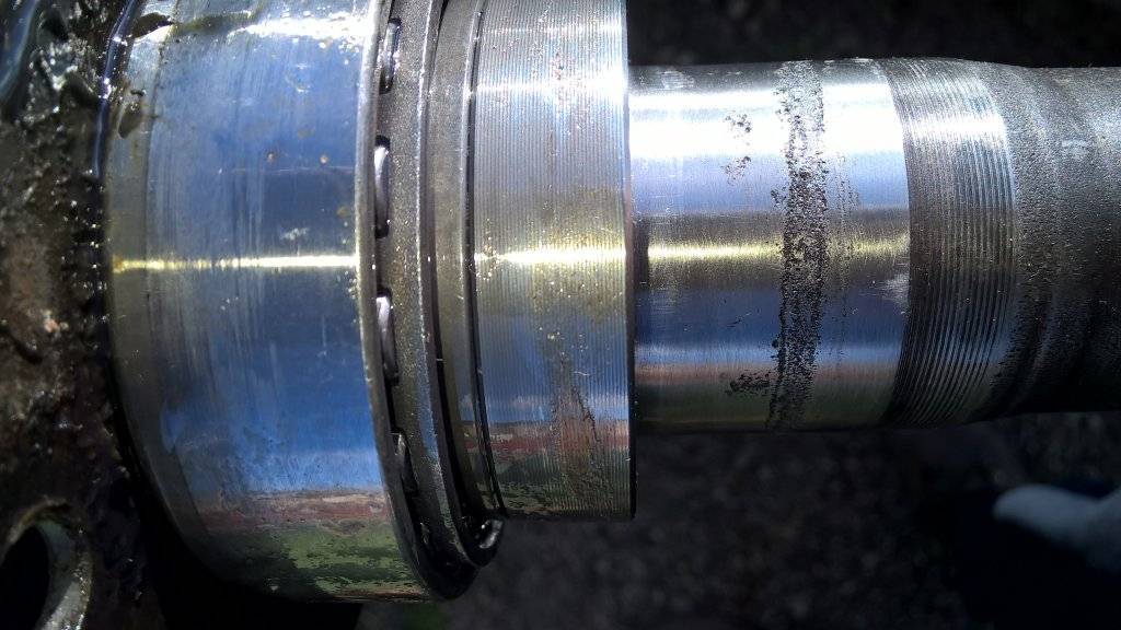

I brought my car, 71 New Yorker 8 3/4, 2:76 sure grip to the shop for a complete rear brake job, and new seals and bearings. When they opened it up, they found the left side axle was rusted where it meets the inner oil seal. I brought them an axle I had from a 71 Polara 8 3/4, 2:76 sure grip, and it was at least one inch longer!? Went back to the garage pulled the left axle from my 71 Newport 8 3/4, 3:23 sure grip, we have a match! The New Yorker has the 489 case, Polara 741, But still, this has me perplexed, any thoughts? Thoughts on the rust welcome as well.

Is there a seal out by the axle flange between the flange and bearing?
Yes, you can just make out one of the bolt holes of the cover of the grease seal in the lower left corner. The oil seal that goes in the axle housing sits where the pitting is visible. It was rusty there and when they removed the rust the pitting remained.

Are those bearings packed in grease or do they get lubed by axle oil? With a inner and outer seal they wont get axle lube.
The bearings are packed with wheel bearing grease only, heavy weight axle oil for the diff. The two don't play well (oil will wash away the grease). that is the purpose of the inner oil seal and why the axle needed replacement, also axle oil on brake shoes is no good. The outer seal is more of a dust boot to keep brake dust from contaminating the wheel bearing grease.
I have seen the same thing on the AMC 20 rear end in jeeps, I haven't had a 8 3/4 apart in so long I couldn't remember. The older dana 44 in jeeps are that way also and even have a grease zerk on the housing.
