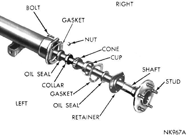

Is there room to press 2 bearings onto this shaft? One just doesn't seem to be enough...
This is a job that I think I'm going to tackle next year, I've never seen the inside of the axle tube yet myself, but it sure looks like the shaft would take a second bearing:

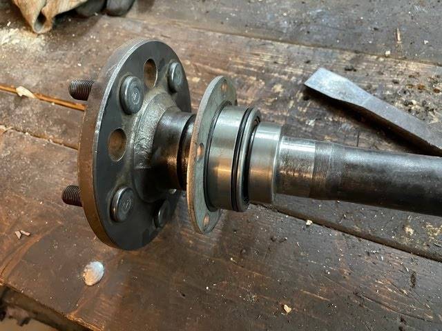

This is I think a fresh install of a green bearing, which is maybe a little wider than a tapered roller? It looks like there's room enough to put a second bearing there with the collar pushed out a little to the right. There'd have to be room enough in the axle tube for that, and the inner oil seal.

There are 2 bearings in the rear, where the torsional and fritional pressures exist. One in the carrier where gear torque is initiated and one at the flange plate where traction forces are imparted. The space in between doesnt need more bearings. And adding one would add extra expense with little improvement. If the flange side bearing failed and you have pressed one inboard of it you'd have to replace both. They dont unpress. The front hub bearings are only so close together because of their mounting structure. Unless we're talking a 4x4 which would also be different depending on fixed axle vs independent.
I see no benefit for another bearing. To the contrary, because 4 bearings instead of two would increase the likelihood (chipping) of a bearing failure. And then they would both require replacement if either one fails. Parts left out cost no money and cause no problems, according to that GM president of long ago.

The front bearings have different loads on them. You have side load from turning the wheels and the front of the car is heavier. The fronts also have larger brakes and the front will also have weight transfer under braking. So, 2 bearings make sense, especially since they are tapered bearings with a fairly steep angle to take the left to right side loads while turning.
Go to the rear and you don't have the same amount of side load and the weight is lighter. This is why the "green bearings" can work.
There's one other factor.... The rear bearings are substantially larger and if you were to compare apples to apples, one front bearing to one rear bearing, the rear bearings will actually take more load. So, 2 bearings per side on the front and 1 outer bearing and 1 inner carrier bearing. The inner bearing doesn't directly support the car like the outer bearing does, but they are on the end of an ~ 30" axle and that can create some load when the axle moves, pivoting around the outer bearing.
But, if you want to increase the load capacity of the outer wheel bearing, and you are using "green bearings", the obvious choice would be to find a similar sized roller bearing with no taper that would carry more load than the "Green" ball bearings. I don't think it's needed but that's the way to do it.
IMHO, the stock tapered rear bearings are the way to go. They last a long time and (again IMHO) the bearings seem to fail from lack of lubrication rather than failing due to overload. When these cars were new(er) and we drove and beat the snot out of them, you never heard of needing to change rear axle bearings, including on high mileage cars. What I think happens is the grease hardens with age and/or it gets washed away from the inner seal hardening and failing, letting the gear oil into the bearings washing away the grease. The outer seals also harden and fail with age and that lets dirt and brake dust filter into the bearings too. On the cars I've had to change axle bearings, the grease (or actually lack of it) on the old bearings confirms my opinion.
This is bench racing at it's finest, but the race is going to be DNS once the OP finds out there's nowhere to put that 2nd bearing race, regardless of all that extra room on the axle shaft for the bearing itself.
If you did put two bearings, wouldn't the inner one block lubrication re-fresh (via the axle fluid) of the outer one? If the bearing that's there is rated for the load you're applying, might as well not over-think it.
The bearings are greased and divorced by inner seal.
The 2 bearing theory cannot work with that style of adjustable taper rollers.
