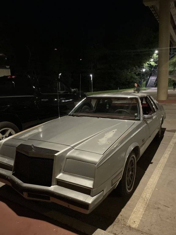

Hello, I bought and have been doing some minor repairs on an 81 Chrysler I bought with 34k original miles and the original EFI system which has served me fantastically, however the starter went bad. So naturally I replaced the starter, replaced the battery, terminal posts, and even redid the wires to the terminal posts, but yet when I turn the key, it cranks but refuses to start. I apply the gas pedal and get nothing from it. I know the air intake system for the EFI is very specific and unfortunately due to the low mileage of the vehicle it was sitting in a garage for a long time so the exhaust rusted off, leaving possible room for O2 sensor faults, so I was wondering if anybody had any advice on what I could do to fix this issue and get the beauty on the road again?
