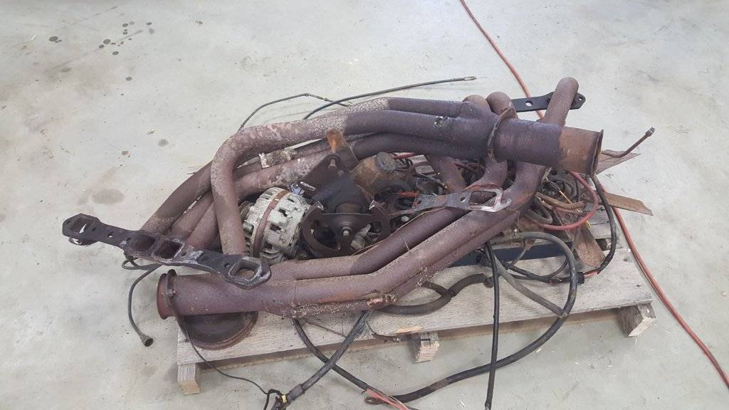

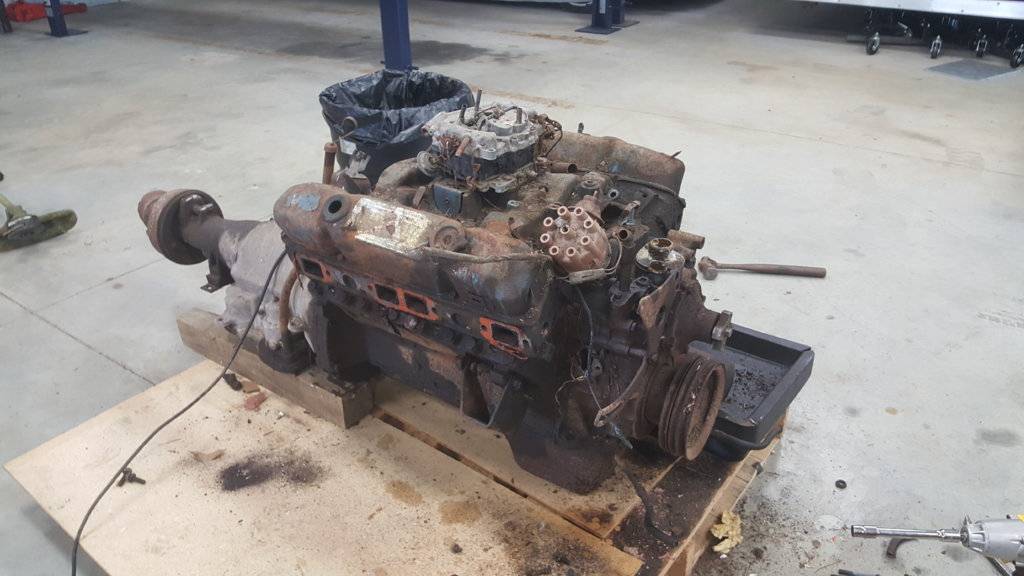

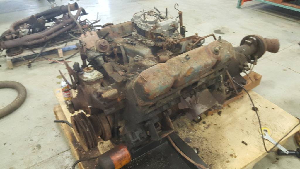

I guess I will post my rant here. I have had many good experience purchasing items on the internet, but I just have to vent my frustration here. I was in the market for a good running take out 440 and transmission. I followed up on a lead to one that was in Florida that was in a motor home and was "running when parked" I contacted the seller via text/email and phone. Got some pictures and the engine looked dirty in the motorhome. Bought the engine and transmission and told the seller that I wasn't in a hurry but needed a window of time for it to be shipped and held at the terminal because I only get home about every 4-5 weeks. Well that didn't work out. I heard several excuses about short of help, couldn't find a freight company, or just plain no answer. So, now six months later.
So, I arranged to fly to Florida, rent a UHaul and pick up the engine and trans. What I found was a rusted mess, probably was a boat anchor for a while. Loaded it up anyway, drove back to South Dakota, unloaded it and started to tear it down. It certainly wasn't a "running take out". Right now I have broken off a water pump bolt, pulled the plugs and it is locked up. Haven't yet pulled the heads, as I had to go back to work. So, I will either have to rebuild the complete engine, or I do now have a "boat anchor". So, I have over $2500 invested in this grand journey!
Pictures tell the story.
You will be able to tell a lot about the condition of this engine by pulling the heads. If there is layered rust on the cylinder walls, it is probably junk. If the bores are rusted but smooth, the engine probably got stuck from sitting. Sometimes you can load it up with penetrating oil and try to remove the pistons one at a time. Good luck.

Dave, Yep, that's the next thing to do. I will be back the end of August, and will pull the heads, hopefully I will not see a rusted mess!
