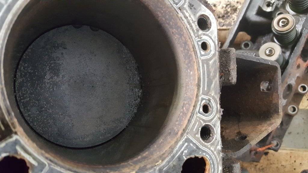

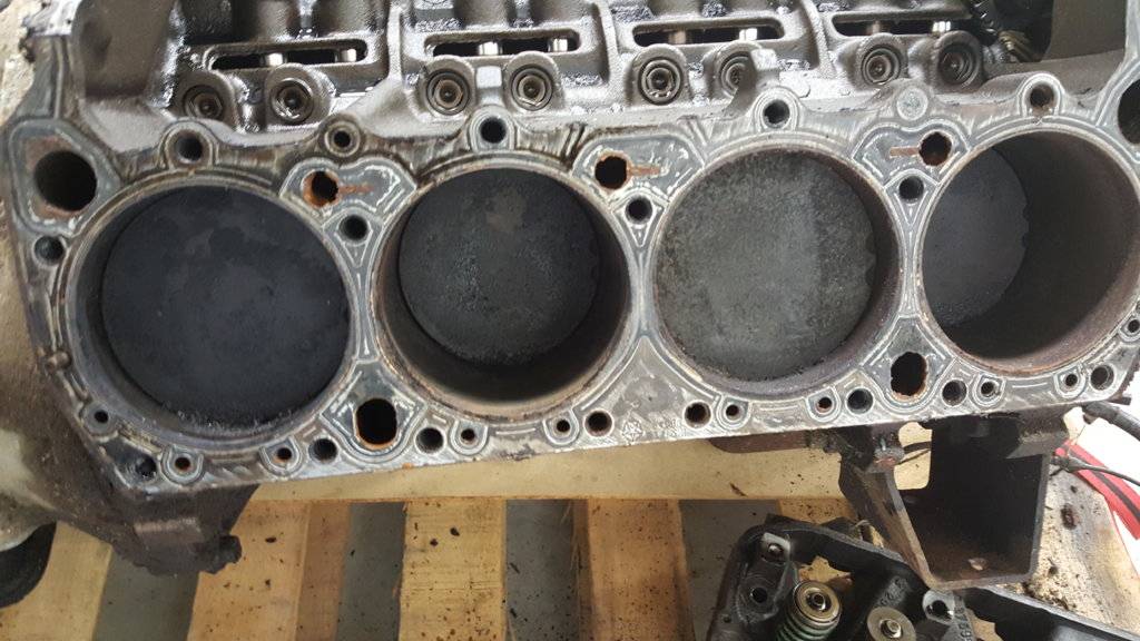

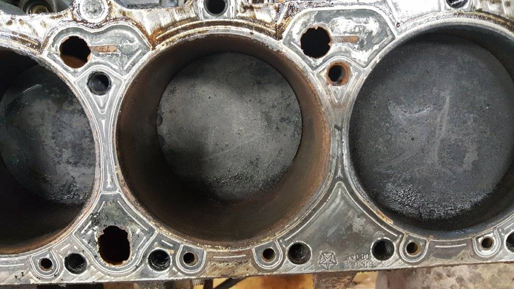

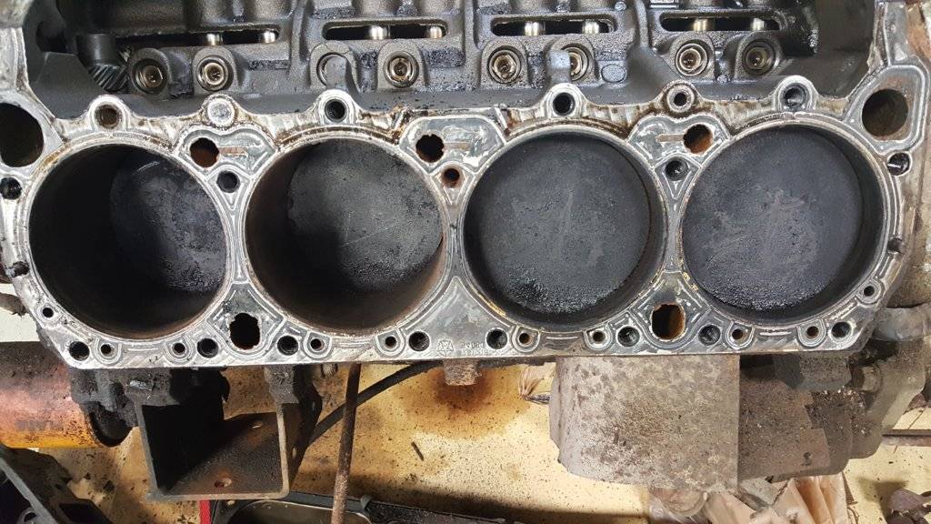

I finally got the heads off of this engine. Had several water pump bolts break off, and had to weld a bolt to the head of one of the intake manifold bolts to get the intake off. Still locked up. Some pictures of the cylinder bores. Gonna let it soak for a month or two. Yank the trans off, and then put it on an engine stand. Go from there!
I would try filling the bores up with some diesel, it has good penetrating ability and well help keep more rust from forming until you get around to trying to pull it apart. The bores show enough rust to have stuck the engine, but I think you should be able to rebore it. Might want to mic the top of the bores to see if it has been rebored before before putting a lot of work into this engine. Once you get it on the stand, pull the pan and see if any of the rods are fused to the crank as that also will cause the engine to seize up.
Dave
I would try filling the bores up with some diesel, it has good penetrating ability and well help keep more rust from forming until you get around to trying to pull it apart. The bores show enough rust to have stuck the engine, but I think you should be able to rebore it. Might want to mic the top of the bores to see if it has been rebored before before putting a lot of work int this engine. Once you get it on the stand, pull the pan and see if any of the rods are fused to the crank as that also will cause the engine to seize up.
Dave
Dave, thanks, Next time I am in the shop I will dump some diesel (I have a few 5 gallon cans of red dye!) I really do not see any stampiings on the pistons showing oversize, but you are correct, will have to see how it measures when I take it to the shop. Sometime in the future! So he said!
I am still not sure it it has been under water (in one of the hurricane floods in Fla.)
I used the diesel trick on a motorcycle engine once that was froze up, got it loose and running again. Smoked a little, but was running good other wise. Oil control rings must have been stuck.
If they get water in a cylinder bore there will usually be discoloration of the piston and some heavy white oxide where it got wet. I mainly see lots of carbon on your piston tops, so I do not think it went for a swim.
