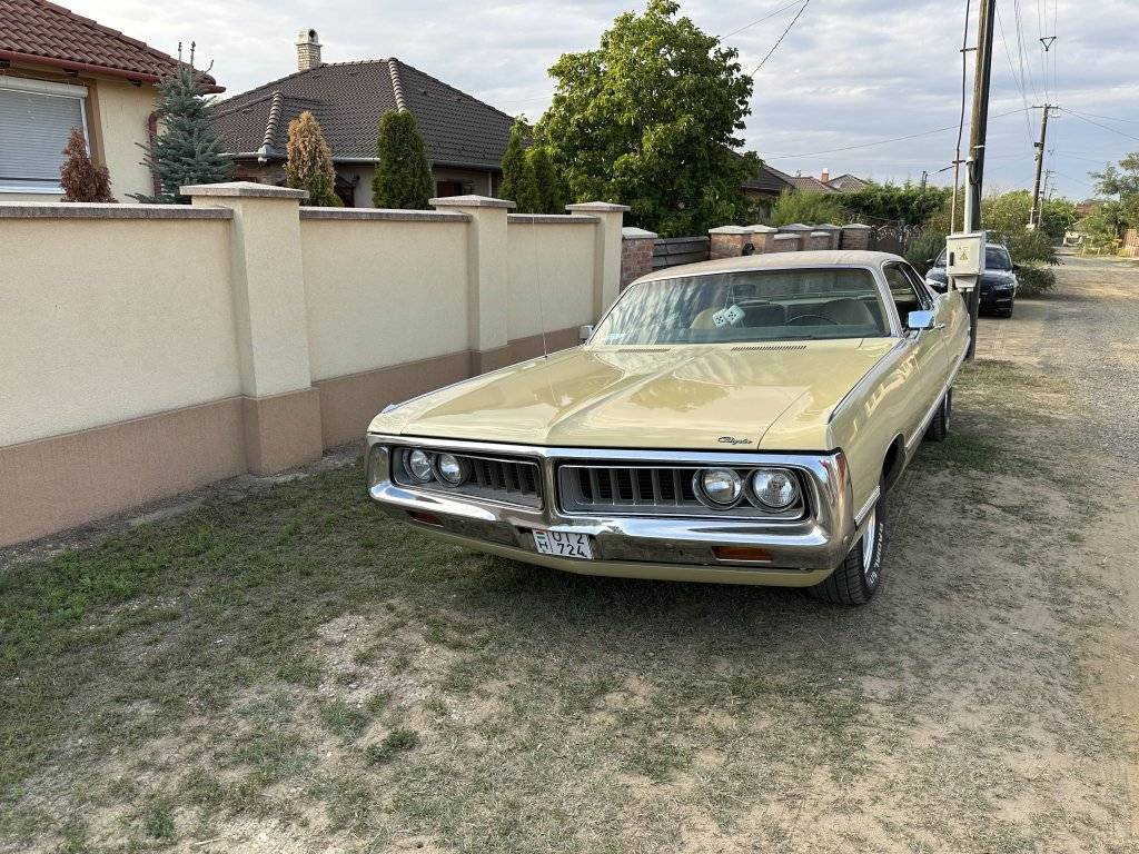

Hi All,
I am looking for driver side A pillar post holding for my 1972 Chrysler Newport Custom 2dr 440. Could anybody knows that same year Mopar or Plymouth has the same size A pillar post? My car is waiting for OldTimer certification exam in Hungary and my A pillar post molding is broken. Could anybody help where I can get one or can I use any from other brands in the Chrysler family?
Thank you very much for your help!

Assuming you mean the A Pillar plastic? That part is the same for 69-73 all C bodies 2dr and 4dr hardtop

Is his car a hardtop or a sedan? If the latter, I was thinking you might have one from the 1973 green NYer sedan that you parted out a few years back.
His looks like a 2dr and I have plenty. They fit 2dr and 4dr hardtop. Like windshields. Wagon and sedan. 2dr/4dr hardtop. Except in this case the convertible pillars are on their own...for obvious reasons.
You're right. What I mistook for a B pillar, is a rear window that's not been pulled down. Next time, I should read the OP more carefully as @Istvan explicitly says it's a 2dr... :rolleyes:
